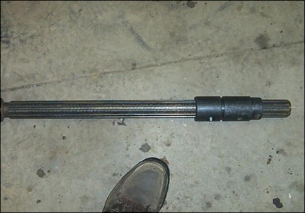

I always used these from power clutch and drive. they usually have
them in stock.
the parts are made by Neapco,
the male # is 72-2231
female is # 53-2415
