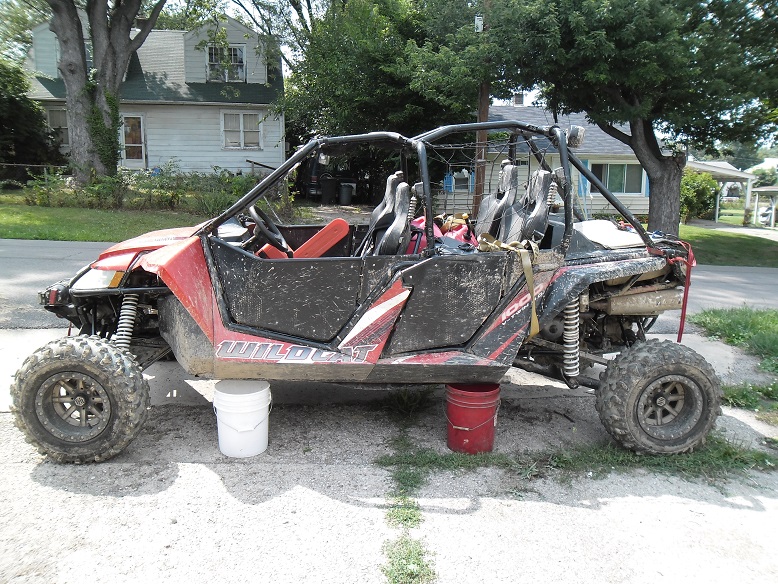

Made a lift kit for my 4 seater. Have very little cost in it. I used steel I had laying around. Used a couple cutting disks, a grinding disk, some paint and a little weld wire. Its about a 3.25 inch lift

Looks good.definatley need some bigger rubber though.

I can't keep the drive train together as is and the next size up tire is more than 100 bucks . I can't justify that much for 1 inch taller tire

What size tires are on it now? What did you do to lift it? Lower the shock mounts...

They are 26 inch. Front 9 inch wide rear is 11 I think. Yeah I made brackets to extend the shocks. Lowered the top of the back mounts and raised the front lower mounts
Oh 14 inch rims. Got to much invested in wheels to change rim size

I read that lifting them makes breaking axles easier. When my tires wear out, I'm going to 29's.

I'm on a wildcat forum. Been a fair amount of people that have done a 3.5 inch lift and haven't had more than normal axle issues. I had waited for results. The axle angle doesn't look to bad but we shall see. I already blew the gears in trans from stress I don't want to add even more weight to the wheel and break the gears sooner. Wildcat needs a separate trans divorced from engine but I have to deal with what I have
