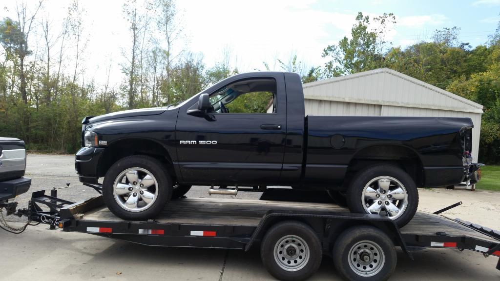

Picked this up from Cincy Thouroubred Harley Davidson. Was a parts hauler till it got side swiped on the highway.
Parts that I will be keeping on the truck are part of the front end, most of the frame, motor, trans and cab. Sold most of what I am not using to help the funds. Still wondering if the cab should go or not.

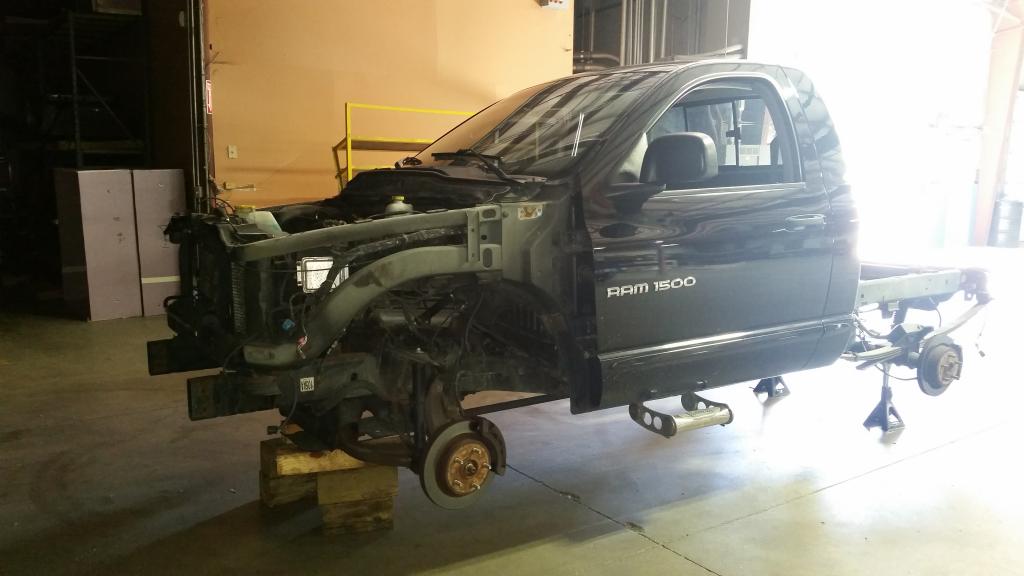

Stripped the 1/2 ton bits away from the chassis. Lightening mode now.

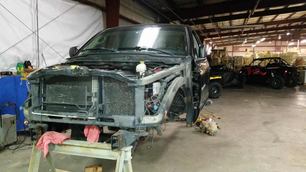

Moved to the welding / fab area. Still shaving weight.

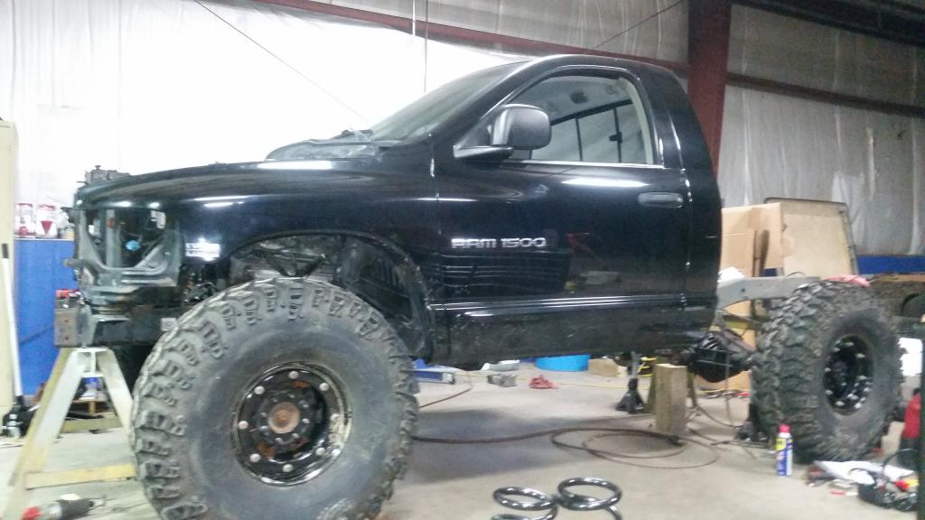

Mocking up suspension and links. 86" wide x 126" wheelbase. Machined a custom overdrive power steering pulley. Hit the mark!

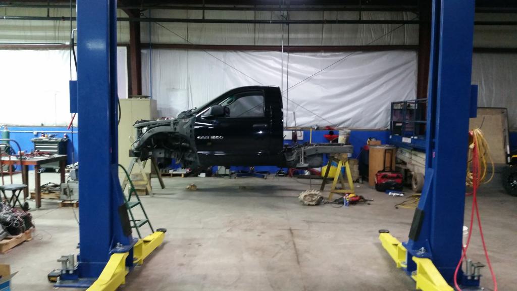

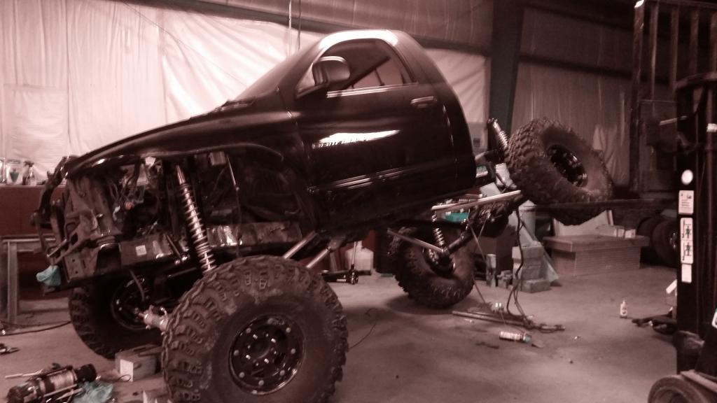

Suspension is tacked in and front bumper is being built.
