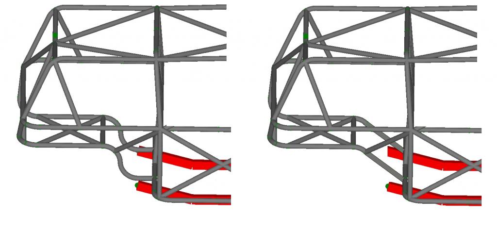

Old 09-13-2018, 04:20 PM   #9
Nice! I like it...
Looking at the S-curves at the rear of the box frame, are those needed for clearance? Or to mount something? They might be simpler and stronger if you just bent one 45 and straight down to the crossmember...

Old 09-13-2018, 04:23 PM   #10
Simply to be different
Old 09-18-2018, 10:53 AM   #11
barnhartal
Join Date: Jan 2012
Location: Swanton Ohio
Posts: 20
If your planning on a future rear seat, push those s curves back as far as rear upper link clearance will allow. Mine has similar curves and when I put rear floor in for kids it kind of screwed them for footwell. Livable but not great.
Old 09-26-2018, 03:20 PM   #12

Old 09-27-2018, 08:00 AM   #14
That may be an adjustment we make once we get started on the rear section of the chassis.
