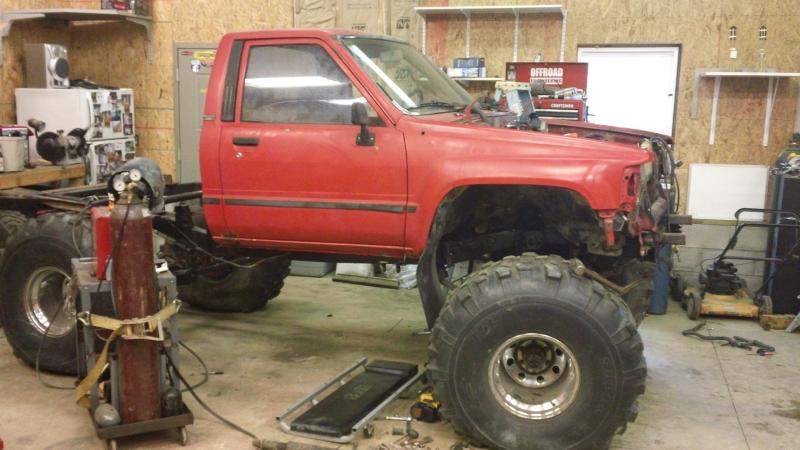

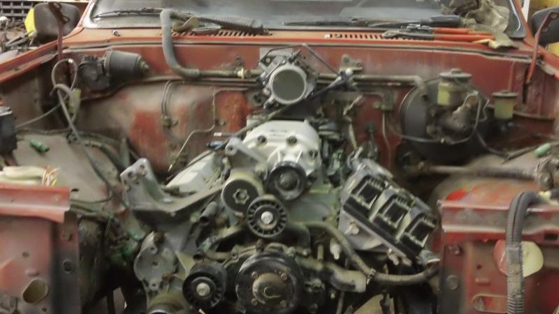

supercharged 3.8 in yota
few pics of install

Old 01-22-2012, 03:15 PM   #2
Me and stickman were talking about doing this to his Yota. That should be plenty of power. What are you mating it to?
Old 01-22-2012, 03:23 PM   #3
th350 to 205. yeah i wanted more than 22re and wanted sumthing different than 4.3. hoping to get close 300hp after tune on pcm

U just running on toyota axles?
Old 01-22-2012, 05:03 PM   #5
as of now, bobby longs. gonna go 60/14b when i find cheap set. hav a buddy with tbi 350 with longs and has minimal troubles with yotas, i just cant c sinking bunch money in yota axles though
Old 01-22-2012, 06:02 PM   #6
Looks like it fits pretty good... U check that clocking ring out for 205 I was tellin u about?
Old 01-22-2012, 07:03 PM   #7
not yet, mite throw my 203 under it to gain little on front driveshaft. it short as it is! who makes clocking ring? one on my buggy is wide open designs and was 300$ hate spend that on ol yota!
