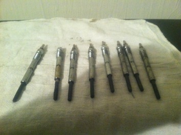

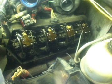

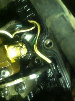

I had one bad, really isn't bad to change them I was surprised.
Old glow plugs

Glow plug where it goes into head

Valve cover removed
