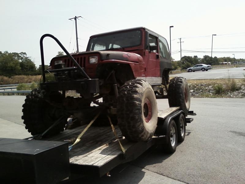

Well picked up this rig. It s a beast for sure
360 V8
4 speed
twin sticked transfer case
2" cage tied into frame
winch
5-42" TSL
rockwells front and rear
front suspension is leaf spring
rear suspension is quarter elliptic 4 link setup.

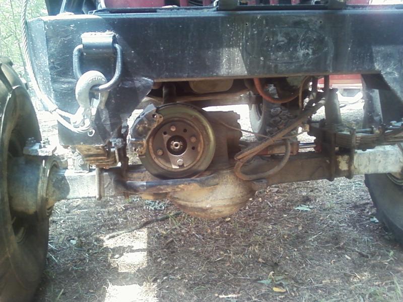

I ve got a few small things to fix on it and it ll be ready to roll. Never done work on a pinion brake before but doesn t look to hard. Just gotta figure out what caliper is on it. The rear one is leaking, bad piston seals.

My pinion kit used 86 yota front calipers, ive seen some others use chevy 3/4 ton as well so maybe one of those

Take a good pic of the caliper and post it up... i bet some one can identify it... I couldn't tell from the pic you have posted...
