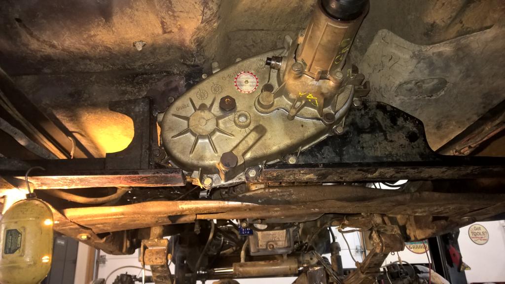

The VSS that is on the tail of the t-case won't work on this setup. I had to drill and tap the t-case adapter for a VSS. This will keep the correct speed even in low gear so I don't have messed up shift points. The t-case has a switch that sends a signal to the PCM so it knows it's in low gear, but the new pcm doesn't have this signal so I can't use it.

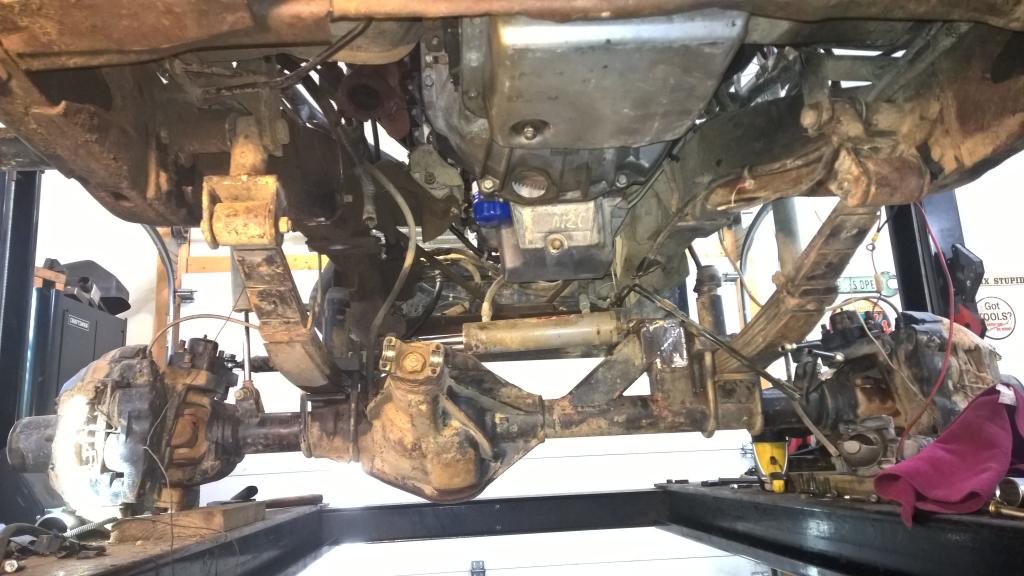

My tie rod and steering ram was behind the axle, and I had minimal clearance between the ram and oil pan on the old engine. The 5.3 will be moved forward 1" because of the new t-case adapter is 1" thicker. So the tie rod and ram had to be moved up front for oil pan clearance. Mark, aka Waffle, moved it up front for me. Now I have to watch out for rocks hitting the tie rod. The plus side is I can lower my bump stops some since I don't have to worry about my oil pan smashing my ram anymore.

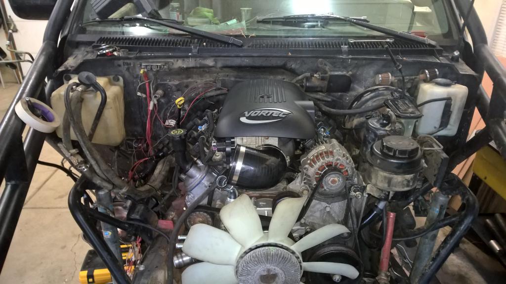

Got the engine done and dropped in.

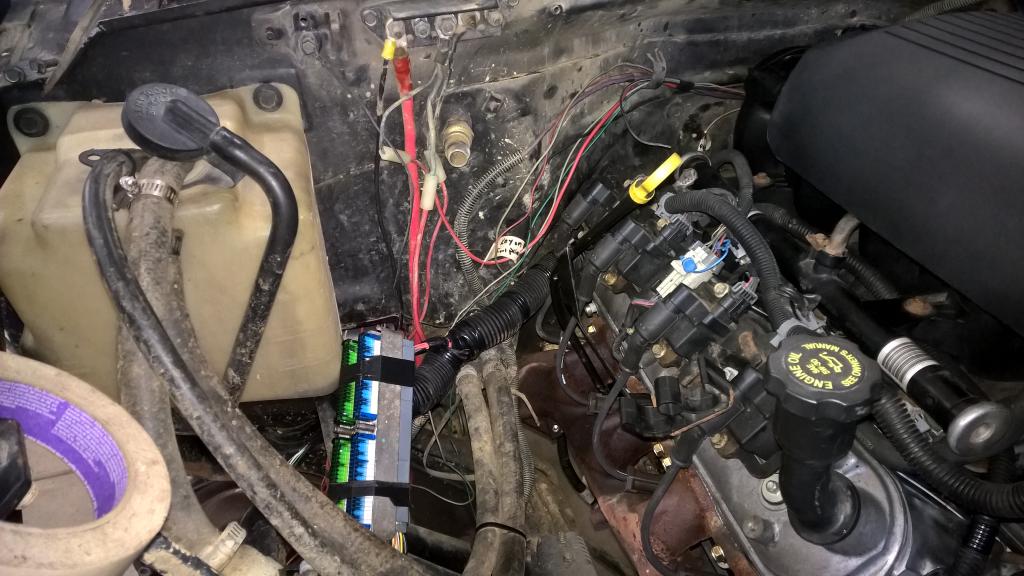

The PCM is going where the coolant bottle is. I will have to get a smaller one and relocate it. It should fit nicely there.

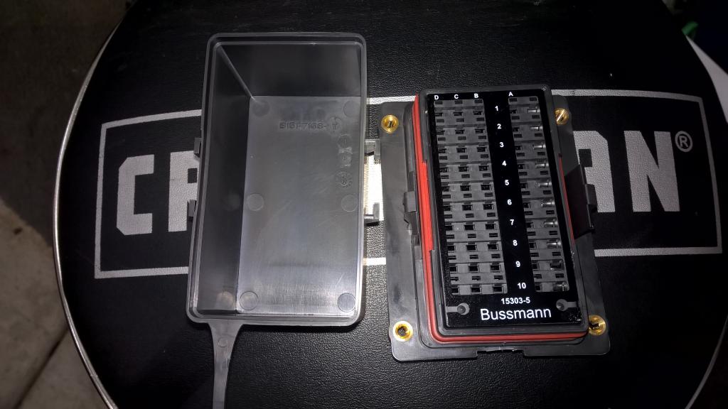

This is what I'm using for my fuse block.

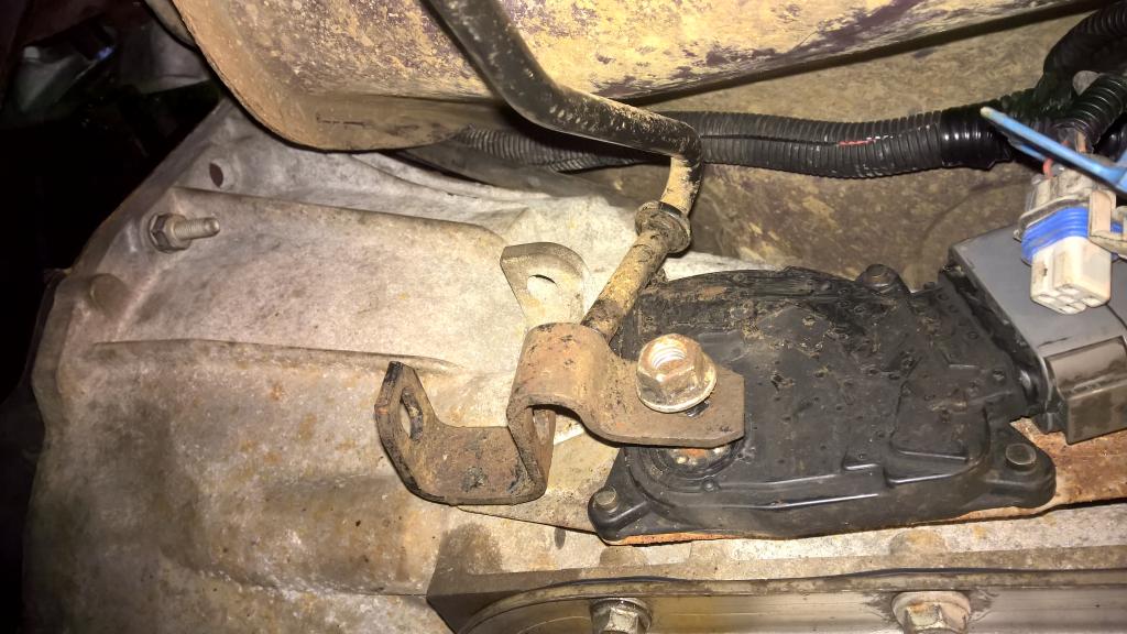

So far the only things that didn't bolt back up are the trans shifter linkage and the exhaust. The new trans has the module on the side so the bracket hits it. The exhaust should be an easy fix.

I have my fuse block wired, and only a few left to run in the cab. I can't seen to find anywhere that will tell you how big the supply wire should be going the fuse block. It is running the basic engine stuff, but not the starter or any fans. Just injectors, coils, trans, pcm, MAF, TAC, O2's ect... I have a #2 awg running from my battery to a factory junction block just above the PCM and new fuse block. My plan is to run a wire from the factory fuse block that is key on power to a relay that will power the new fuse block, and grab the power from the always on #2 wire above the PCM. I didn't think it would be good to draw from the factory fuse block to power the new one. What size relay should I use and what size wire should supply the block? I'm more familiar with house wiring than I am with 12v auto wiring.
Old 06-22-2015, 06:52 PM   #7
Here is a chart, but I still don't know what the load will be on the fuse block. The wires running the injectors and most everything else are small, like 16-18 gauge. I have 7 - 15 amp circuits and 1 - 20 amp. That's 125 amps. So according to the chart, I only need a 10 awg supply since it is 18" long. Anybody...
