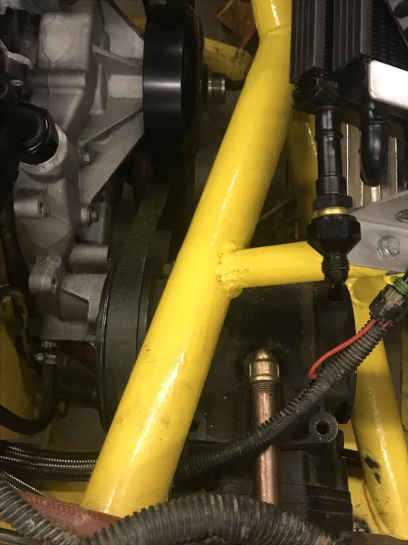

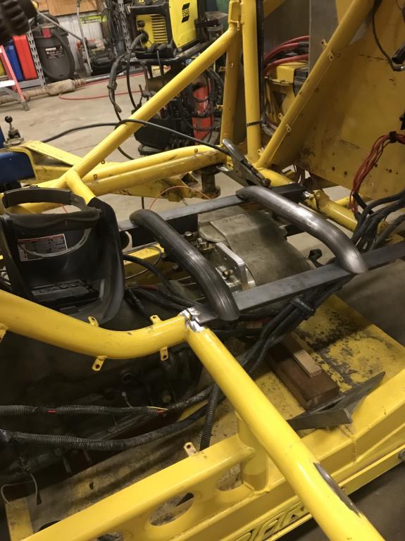

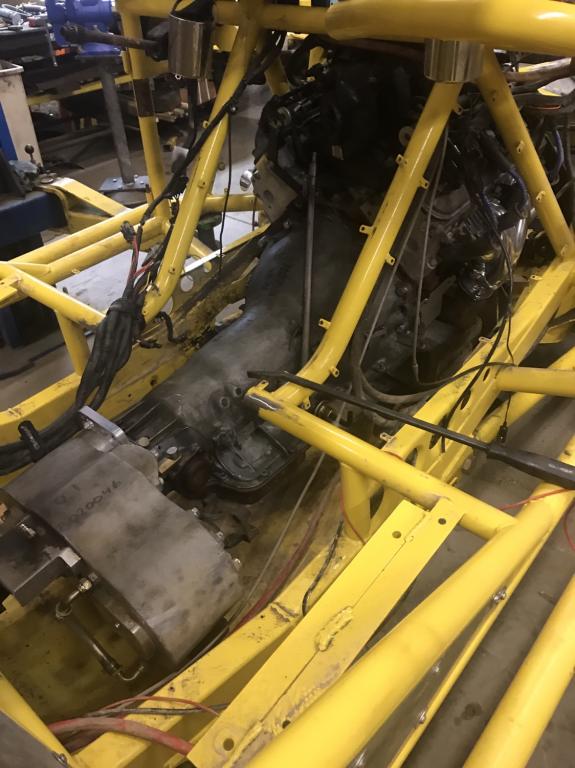

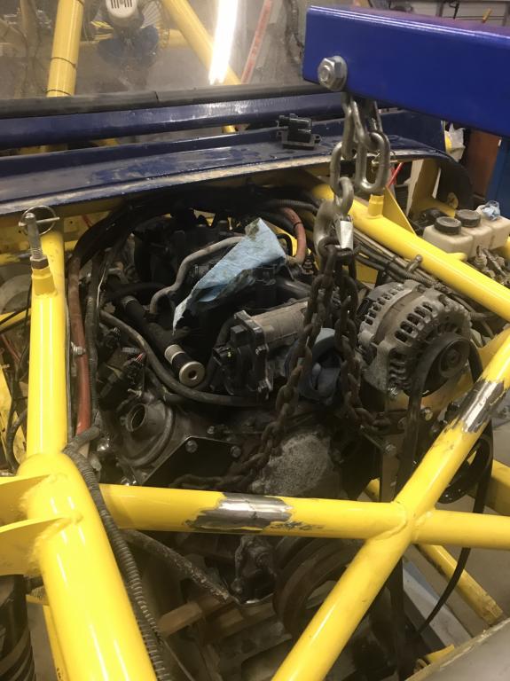

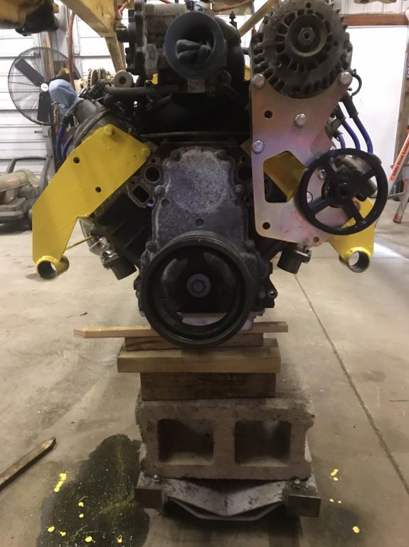

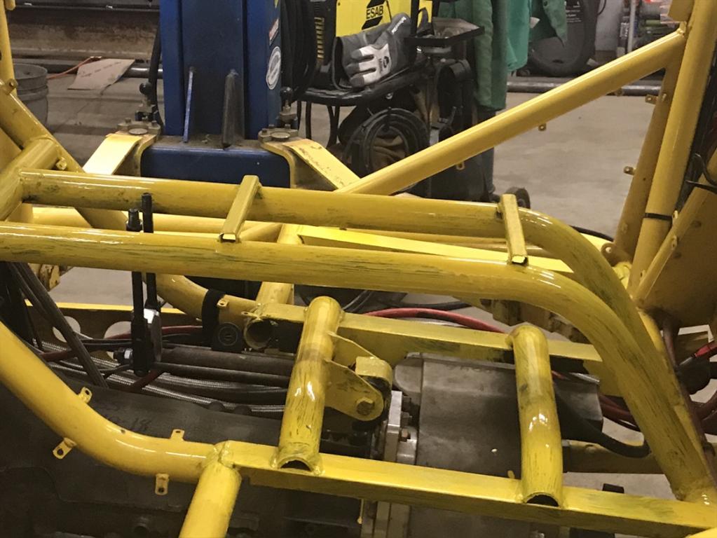

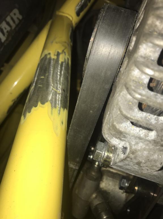

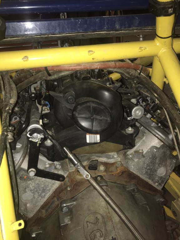

Old 11-19-2018, 03:44 PM   #4
Looks pretty snug. Any issues?
Old 11-19-2018, 03:47 PM   #5
Yep. Coil packs. Gonna look into it tomorrow
Try to maneuver it better. Zach won’t want hear this
Old 11-19-2018, 08:47 PM   #6
You can always relocate the packs and get longer plug wires. Are they all in the way or just a couple?
Old 11-20-2018, 10:31 AM   #7
I mentioned flipping the coils backwards (if that's possibly) and getting a longer set of wires. Lester also came up with a good idea on Facebook. I guess Jegs sells this rack where you can mount and hang them in any location you need.
https://www.jegs.com/i/UNKNOWN/335/5...MaAiUZEALw_wcB
Old 11-20-2018, 11:01 AM   #8
Just one. I am going to stand it up right and make little tabs for it.

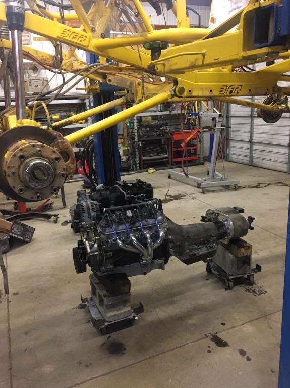

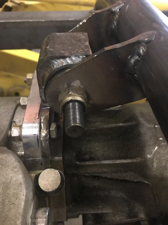

Old 11-25-2018, 10:18 AM   #9

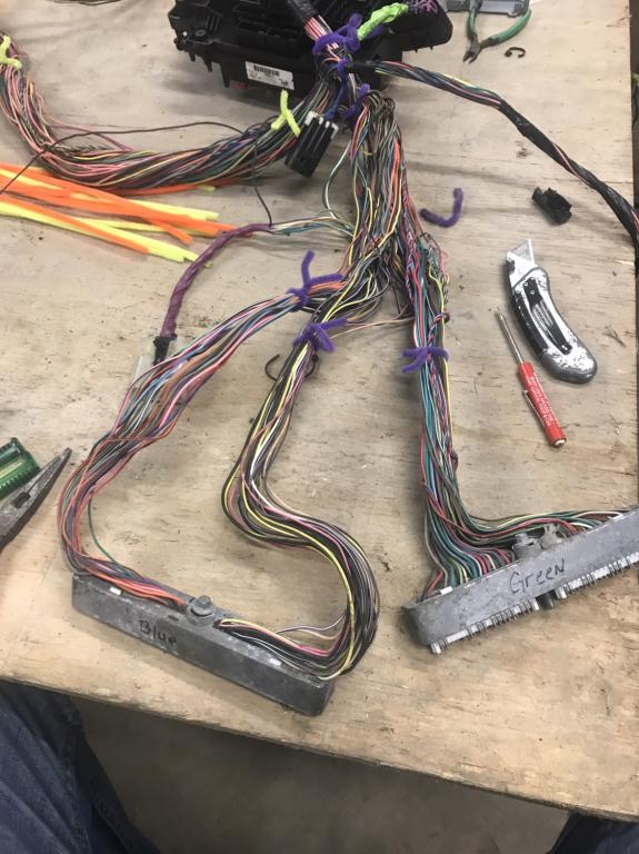

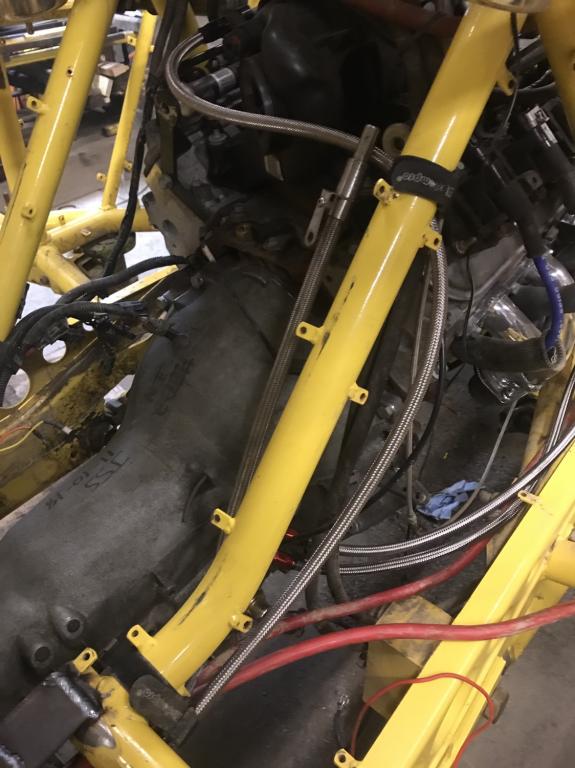

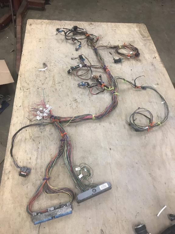

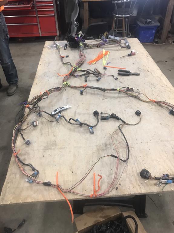

Old 11-26-2018, 02:04 AM   #10
Wiring done today

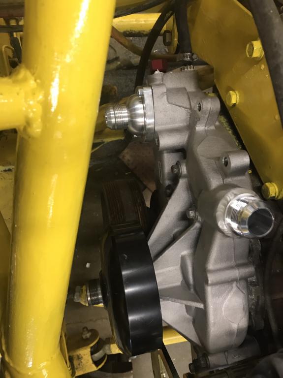

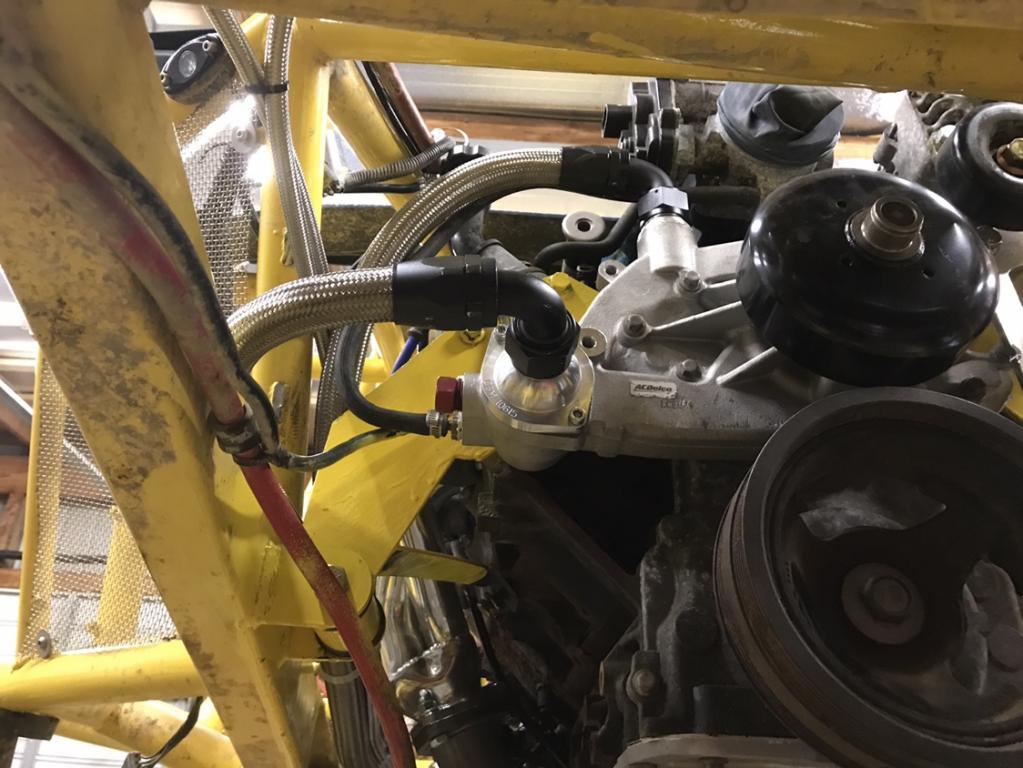

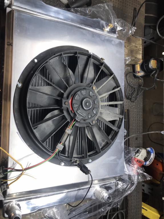

Old 11-28-2018, 08:54 PM   #11

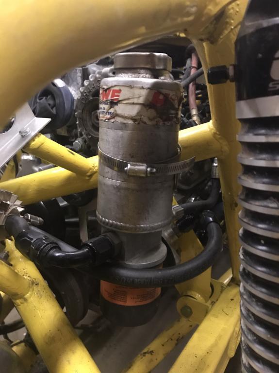

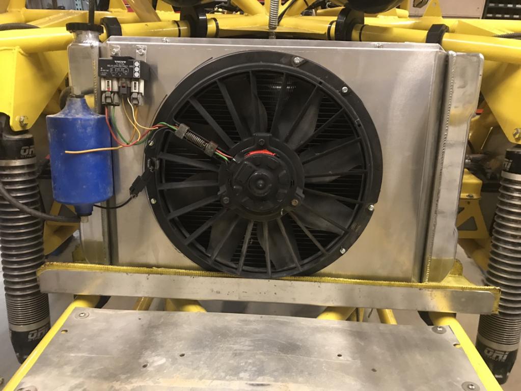

Got the water pump tapped for the thermostat and steam port done. Needed a 3/8 and 1/2 pipe die (harbor Freight $11.89)
Got the shroud cut out for the Volvo fan as well
Ken Garcia did the aluminum welding for me. Doing AN 16 fitting and stainless steel lines

Old 11-28-2018, 09:57 PM   #12
Looking good. I have 1/4-3/4 npt taps and 1/2 - 1 1/4 dies if you ever need them.
Old 11-28-2018, 09:59 PM   #13
I have 1/4, 3/8 and 1/2 pipe tap and dies as well now
Old 11-28-2018, 09:59 PM   #14
Better known as NPT
Old 11-28-2018, 10:02 PM   #15
I also got a sweet bearing set driver if you need to borrow it as well. It has some small drivers in it that we needed for the TH400
Zach’s kit will be here this week. I bought everything g we need to do it and a kick ass book for it as well. Has color pictures and shows how to mod them as well

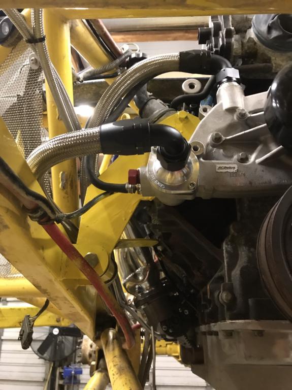

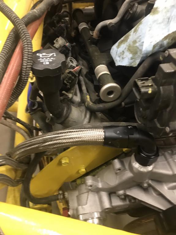

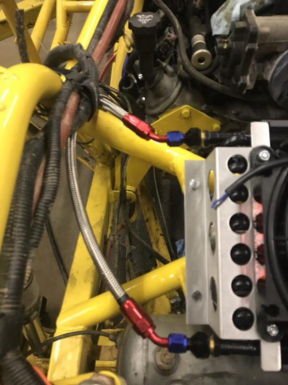

The radiator is installed and lines ran
I really like the AN16 lines. Well worth the money to do these. Really is not that expensive to do.

Old 11-30-2018, 03:23 PM   #19
Those are really really cool, but that's only like 7/8 ID, right? Is that going to be enough flow?
Old 11-30-2018, 11:58 PM   #20
1” is what I bought. Everyone has said yes it will
This is also what they run on the NASCAR cars

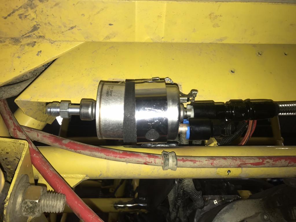

More progress made

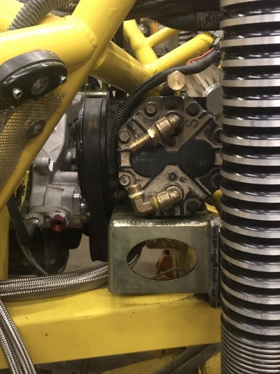

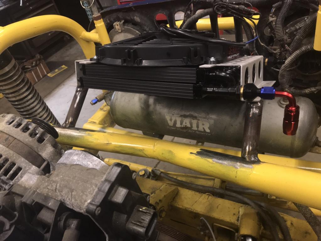

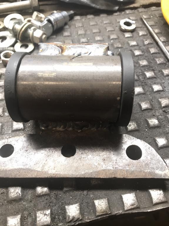

Old 12-03-2018, 08:32 PM   #23
Old 12-04-2018, 12:38 AM   #24
You managed to cram the york in? Nice!
If it's facing backward, does it spin the opposite direction? Does it mind?
Old 12-04-2018, 09:24 AM   #25
AES is sending one that is reverse rotation for me at no charge!. This company is fantastic!
