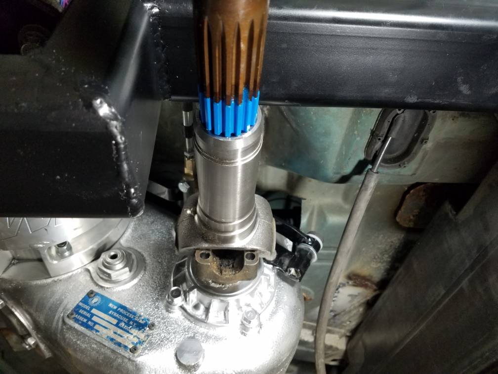

I need to make new driveshafts, so I need yokes and tubing. What is the OD and wall thickness of what you're using? I need to know what's holding up to the abuse we put them through. The last ones I built I used the 2 1/8 DOM I had laying around. I want to use something more common this time.
I also need to know how much slip to use on a linked suspension. I know it won't move as much as it did with the leaf springs. Knowing the diameter of the spline would help too.
I guess no one has driveshafts...
Old 01-17-2019, 01:41 PM   #127
I do but I have a yoda..
I run 1/4 wall Dom.
Don't remember diameter right off,
Would have to measure.
I wouldn't make anything less than 1/4 wall.
I bent or twisted anything less.
Old 01-17-2019, 02:56 PM   #128
I run .1875" wall tube. 14" of slip is good. Too heavy can eat up parts. Best weak link is driveshafts.
Old 01-17-2019, 03:21 PM   #129
I told you what my measurements were. Guessing you need a whole driveshaft?
Old 01-19-2019, 11:30 AM   #130
Tom woods uses 2" .120 wall for driveshafts.
Old 01-19-2019, 11:40 AM   #131
I used 2", 1/4 wall DOM. Ordered my yolks from Northern Drivetrain and Carolina Driveline machined to fit. Made them in the buggy.
Old 01-23-2019, 05:41 PM   #132
I ended up buying parts for 2 in quarter wall tubing. Has about seven and a half inches of total slip. This should be plenty strong.

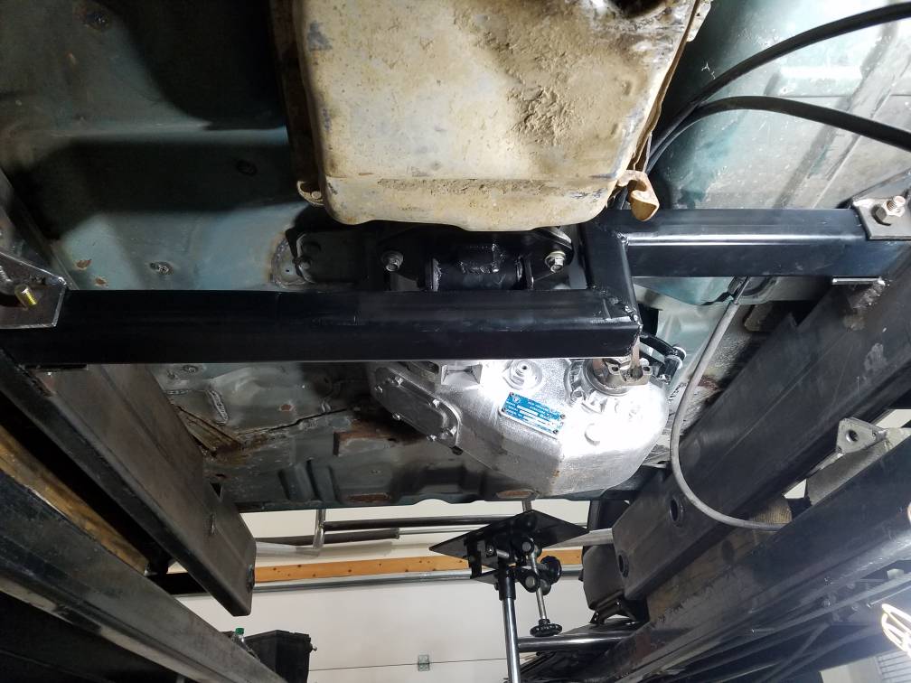

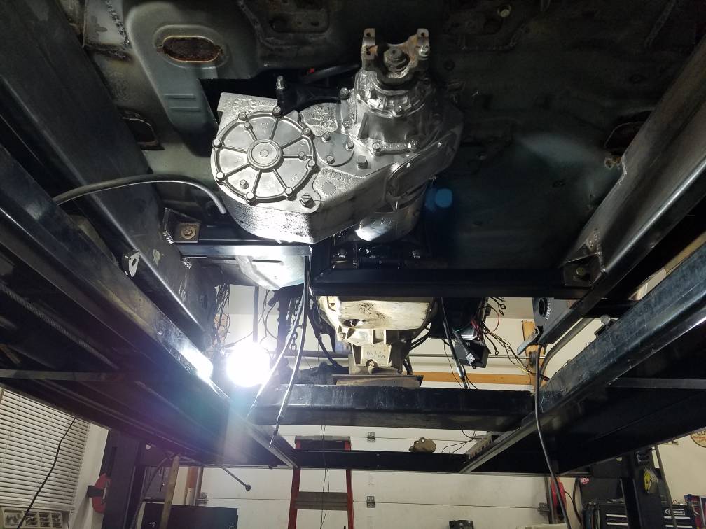

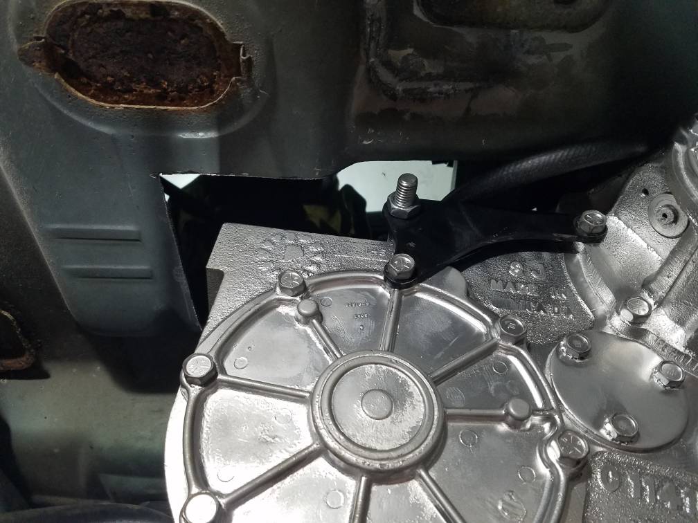

Been working on getting the tcase tucked in and making a sturdy crossmember. My last one was bent up, so I beefed this up. Had to cut a big hole in the floor to get the tcase up where i wanted it. Still sticks out the bottom an inch. So much for a flat belly pan. Oh well, it will be mostly flat...

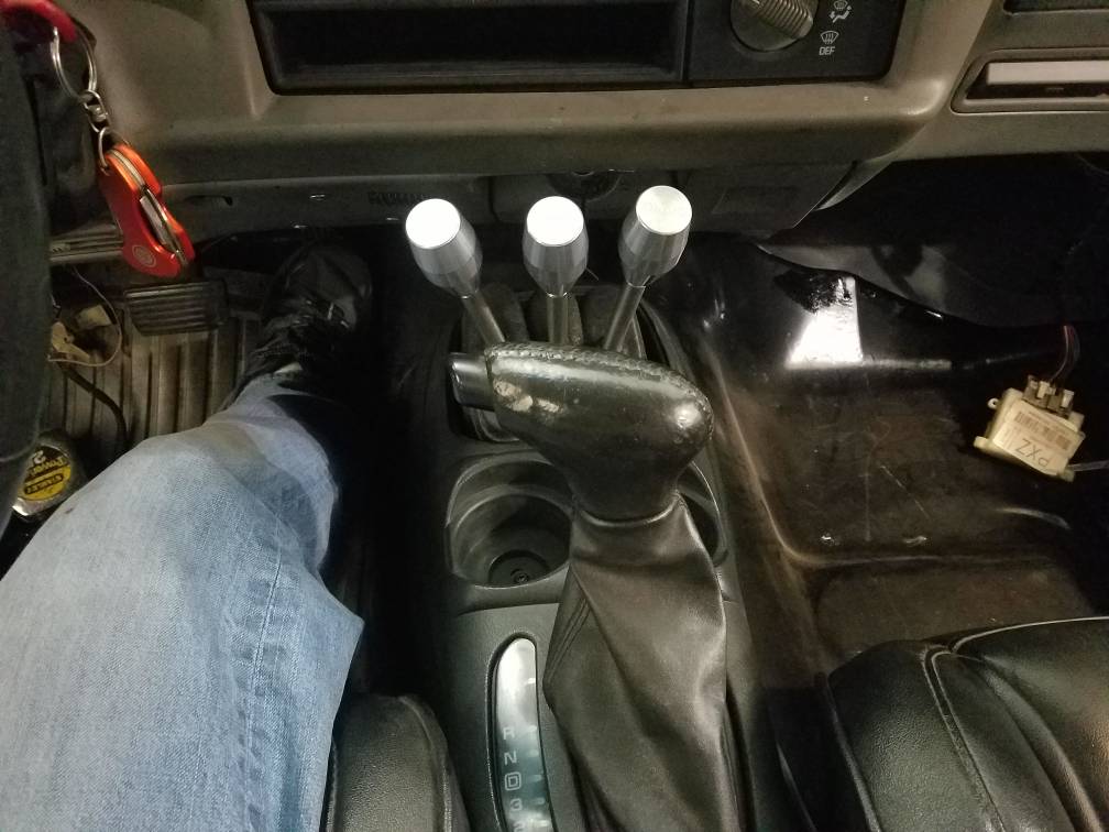

Got my t case shifters mounted in my console. Worked out perfectly by cutting out the square junk tray.

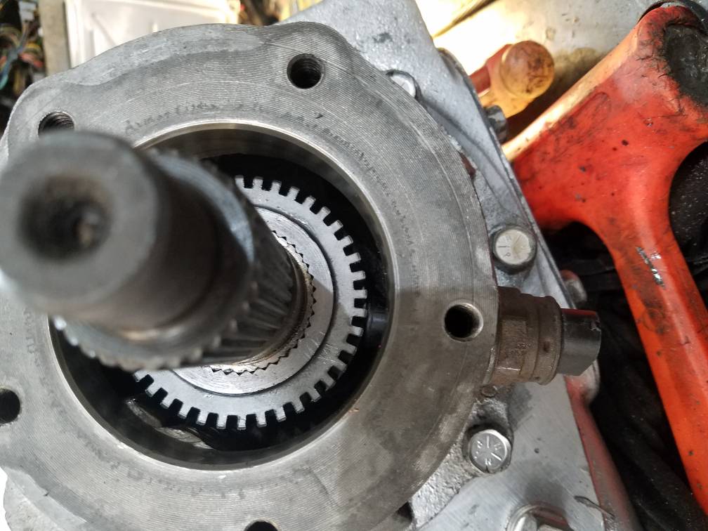

Since I run an electronic trans I needed to add a vss to the system. Luckily the ford np205 has the same 32 spline output as my np241 had. Drilled and tapped the case for the stock vss, and also had to remove about 1/4" off the reluctor ring width. So for a few hrs work and zero cost I have my oem vss setup.

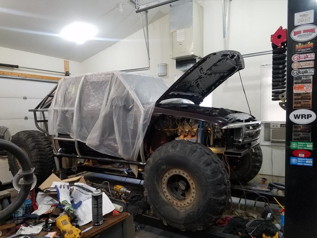

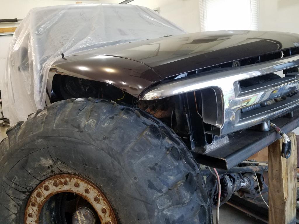

Got the front end back on. Now i can build the frame from the firewall to the core support.

I did the same thing on my Ford 205 for the speed sensor. I couldn't believe how easy it was to add.

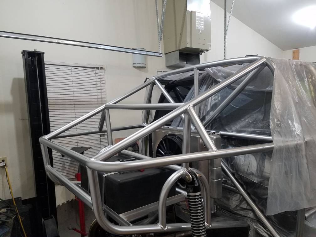

I missed a week working on it cuz i was sick.

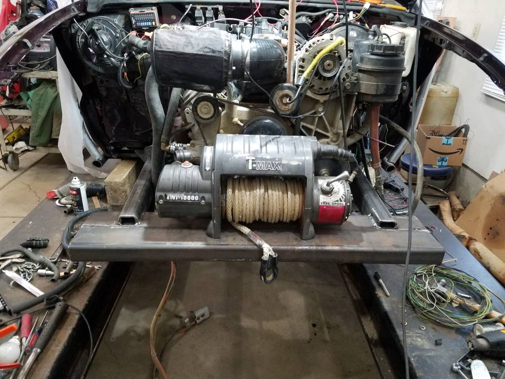

I got the pcm and fuse block mounted, frame and motor mounts done. Winch is ready to mount, and core support cut down to mount on frame.

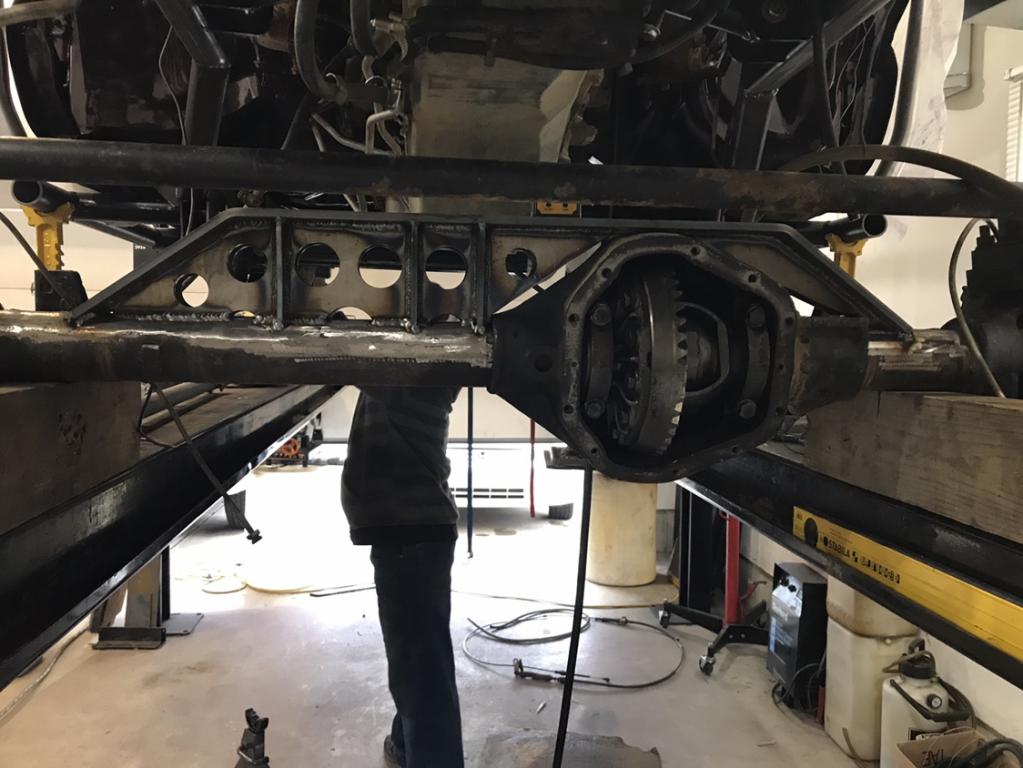

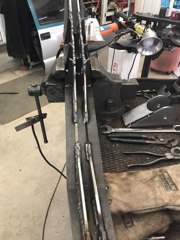

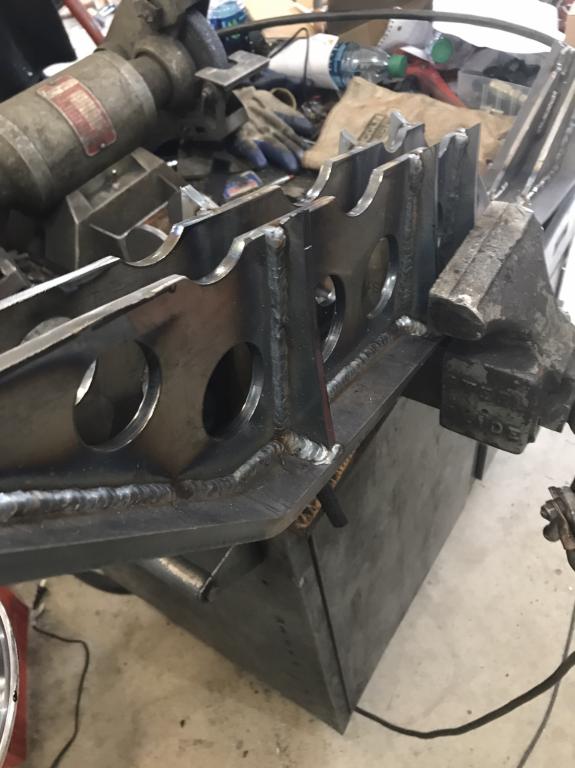

Welded up the trusses, link brackets and set them in place today with Kevin. Gonna be really sweet when done. Click image for larger version

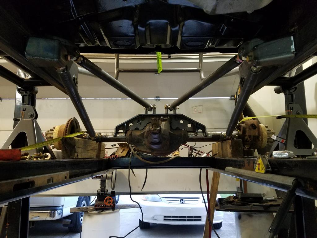

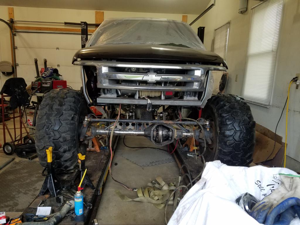

Old 03-26-2019, 10:58 PM   #146

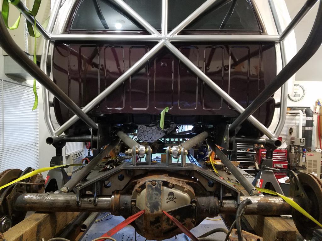

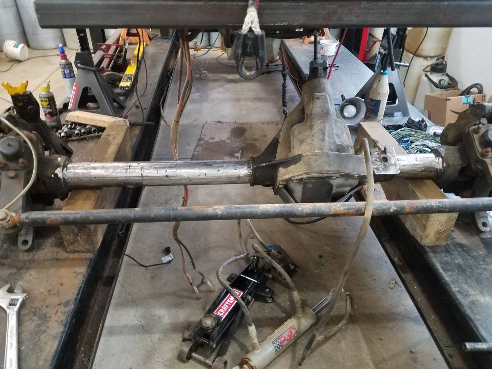

That was a big help, thanks. Like 4 hrs of welding. Finally got the axles under the rig. Got the front and rear truss installed. The front and rear 4 links are almost done.

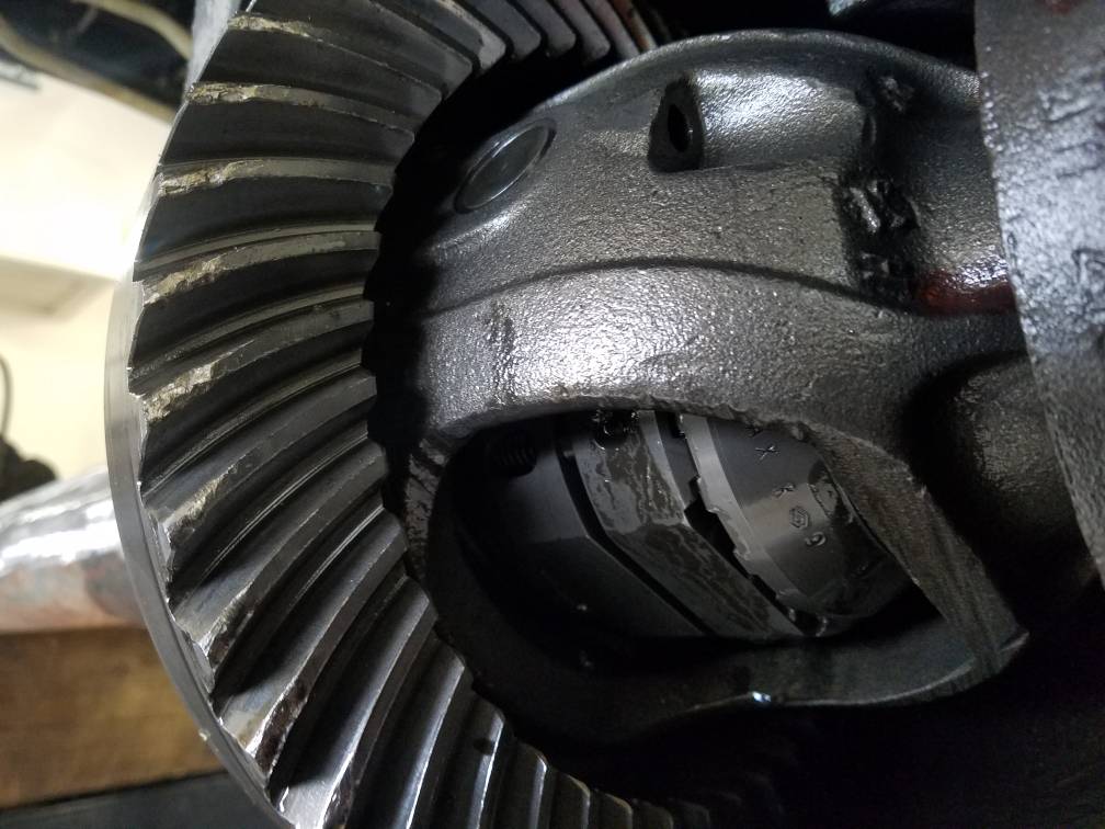

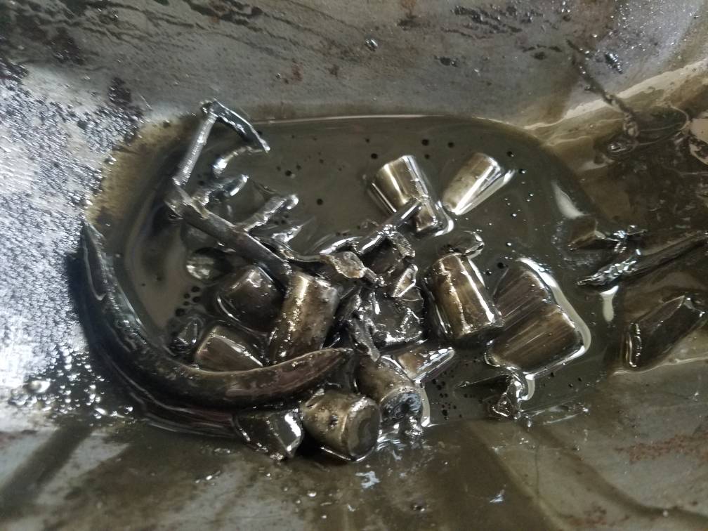

My last trip to Harlan i lost my pinion bearing. I was sure the gears were destroyed, but luckily there wasn't much damage to the teeth.

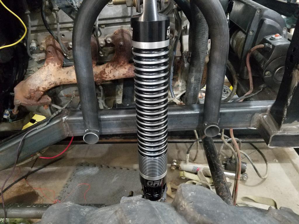

Old 04-03-2019, 12:41 PM   #147

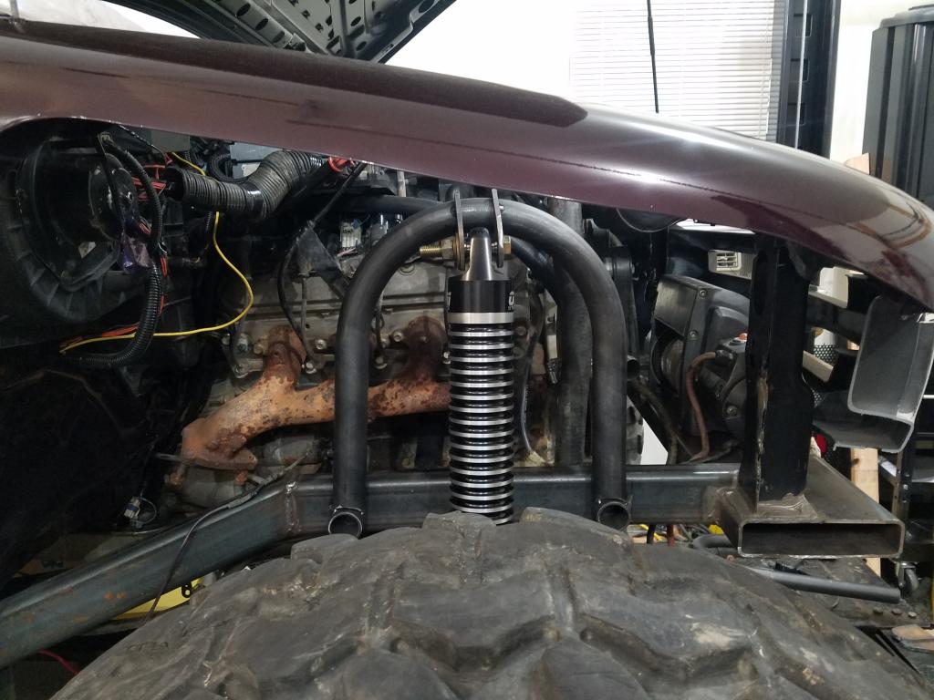

Working on the shocks now.
