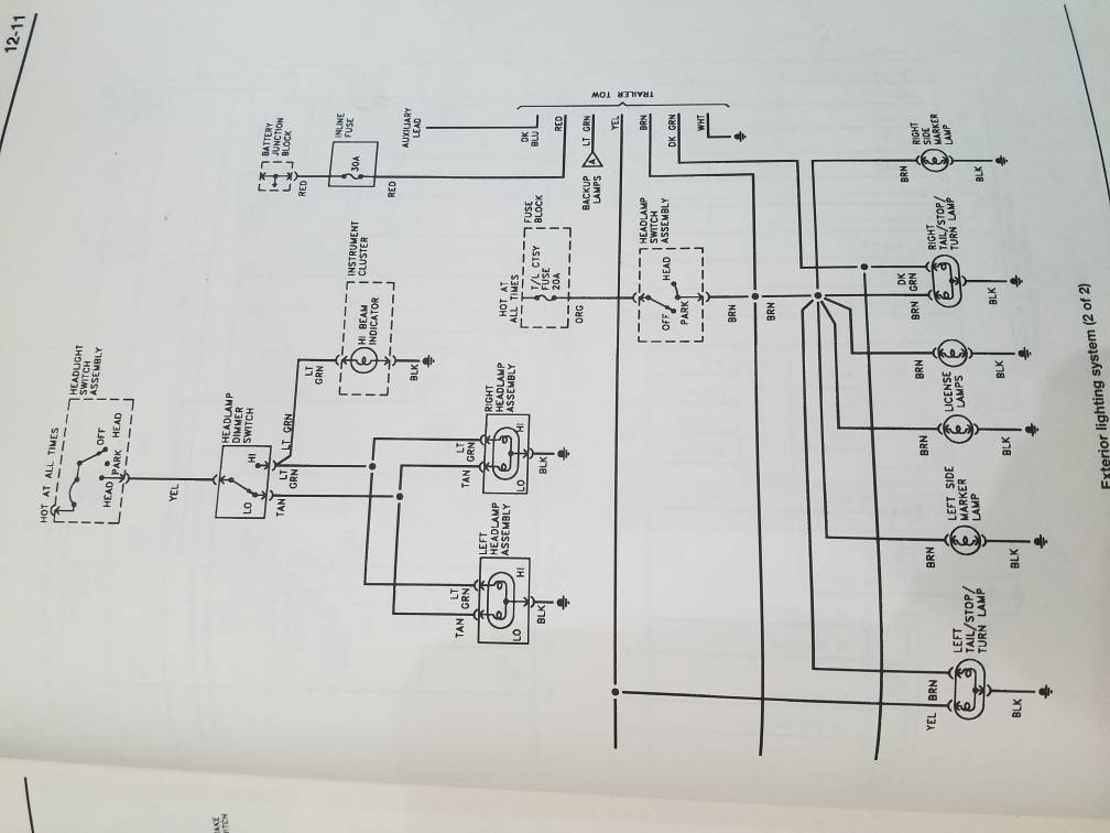

Ok, here's one that makes no sense to me. See if you guys can solve this.

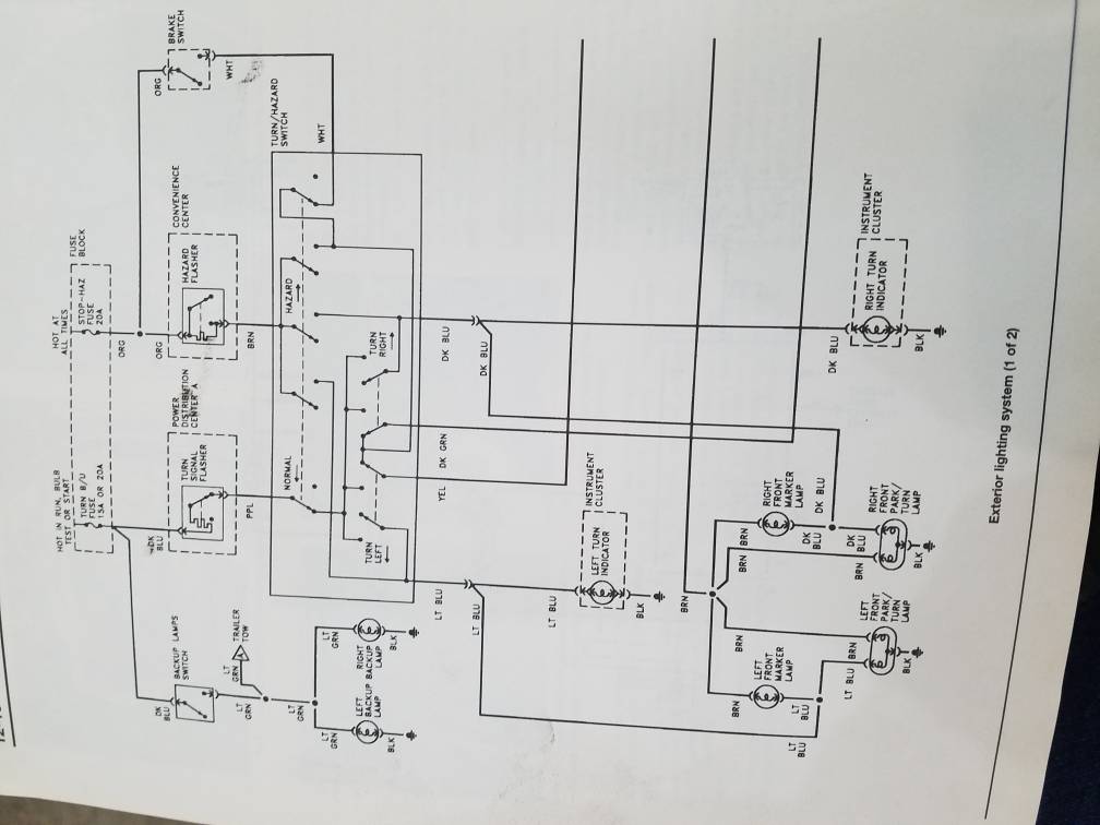

On the s10, the factory harness is running to the back to run tail, turn, back up, fuel pump, and fuel level. I cut the ends so i could reconnect later. So my issue is just with the rear lighting. I have a yellow, green "both turn signals", brown "tail lights" light green "back ups", and a white "brake lights" which i assumed was ground. Nope... I still had the tail light harness and didn't see a white wire anywhere. Where did this white wire hookup to run the brake lights? Any ideas...Click image for larger version

Old 06-18-2019, 09:46 PM   #152
The yellow and Green are also the brake lights.
It's a turn and brake light.
Old 06-18-2019, 10:03 PM   #153
Then where does the white wire go. The brake lights do not work without the white wire.
Old 06-18-2019, 11:55 PM   #154
If yellow is left turn and left-side brake,
and green is right turn and right-side brake,
maybe white is third, high-mounted brake light?
Old 06-19-2019, 04:52 PM   #155
Is there power to the white wire when brake is applied?
The white "Should " be ground
Old 06-19-2019, 04:57 PM   #156
I believe that wire is ran inside the cab.
Old 06-19-2019, 04:58 PM   #157
Yes, power when applied. Grounding it blows fuse when brake is pushed.
Old 07-10-2019, 12:35 PM   #158
I ended up running a diode from the white wire to each turn signal wires and it works like it should. Had to buy some resistors to put inline on the turn signals so they would blink (All LED's). I figured they would fast blink, but they wouldn't blink at all.

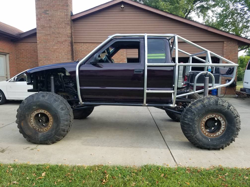

Old 08-11-2019, 08:55 PM   #159

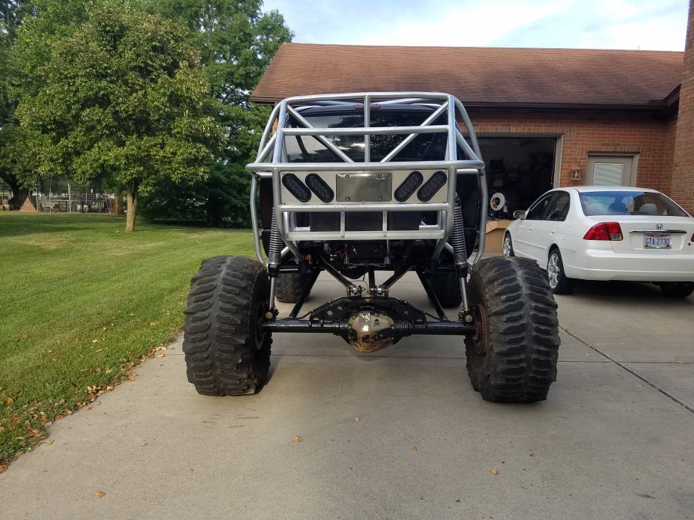

Getting close. Still have the front exo to do and some misc stuff. Sittin a lil high right now. Should settle a bit.

Old 08-11-2019, 09:26 PM   #160
Rig looks sweet and I'm sure it will perform well with the time you put into it, this may be 1 of the only pics we get to see of it nice, After a run up Crawford ' s cry and Lions den it will have a new look.
Old 08-11-2019, 09:33 PM   #161
Nice to see it on all 4’s. Looks really good! I think you will definitely need some wheel spacers in the back.
Old 08-13-2019, 07:36 AM   #162
Looks good. I've always like the S-10 Truggy look, and anything that still looks like a vehicle. Now just needs a new set of 40" stickys on aluminum beadlocks!

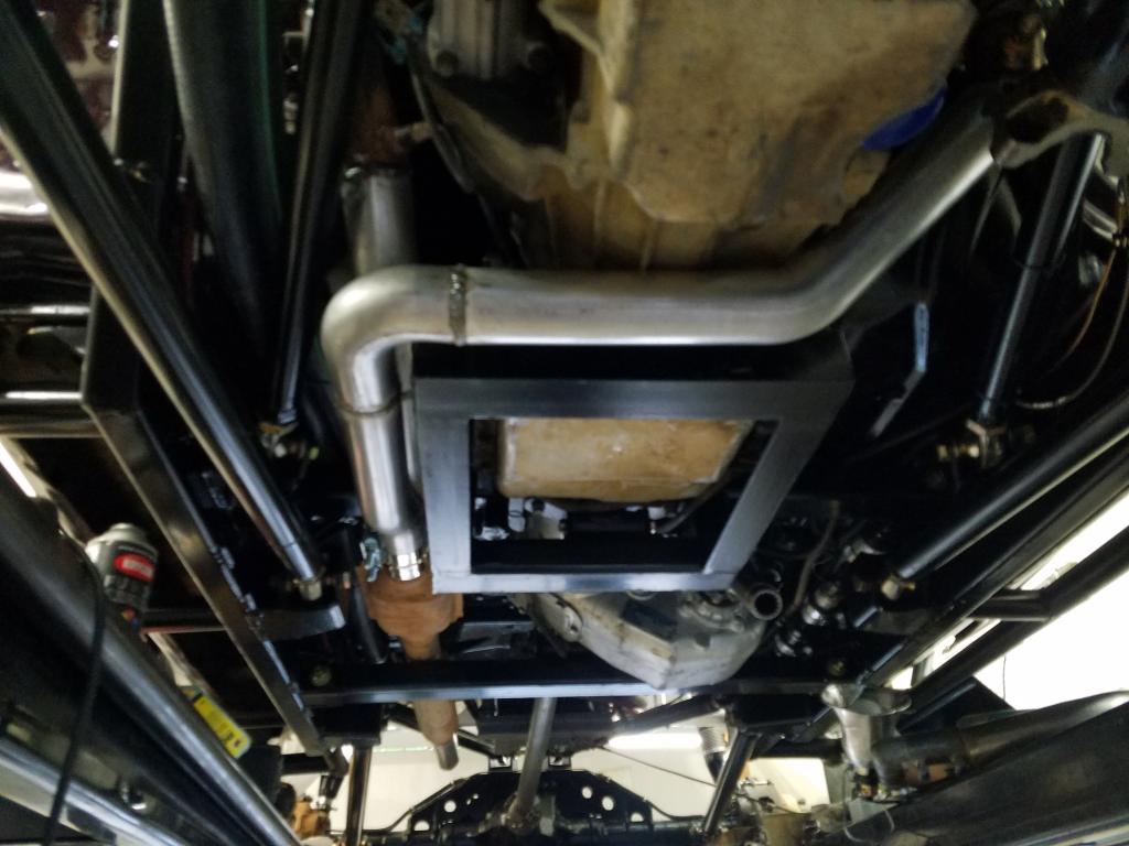

Old 09-05-2019, 10:08 AM   #166

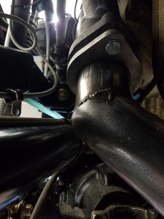

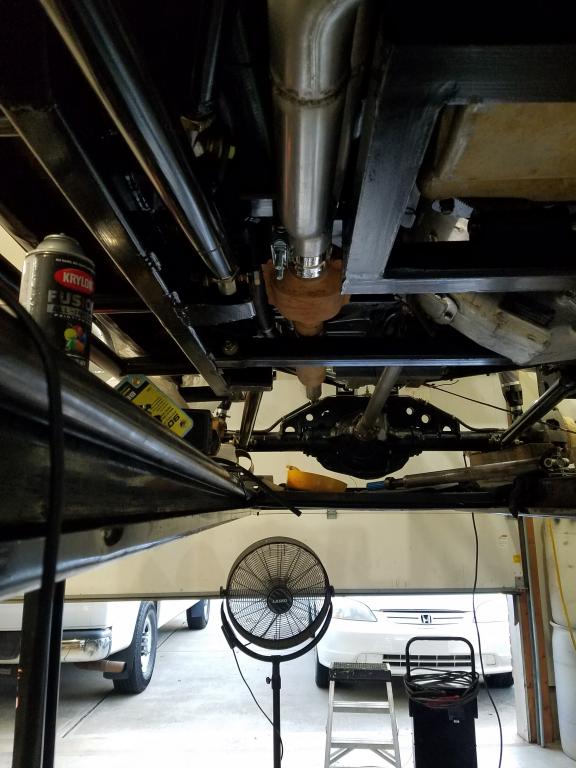

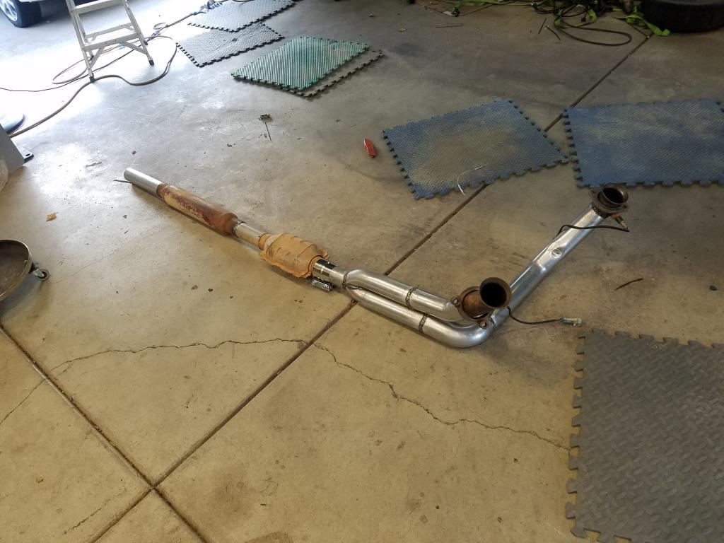

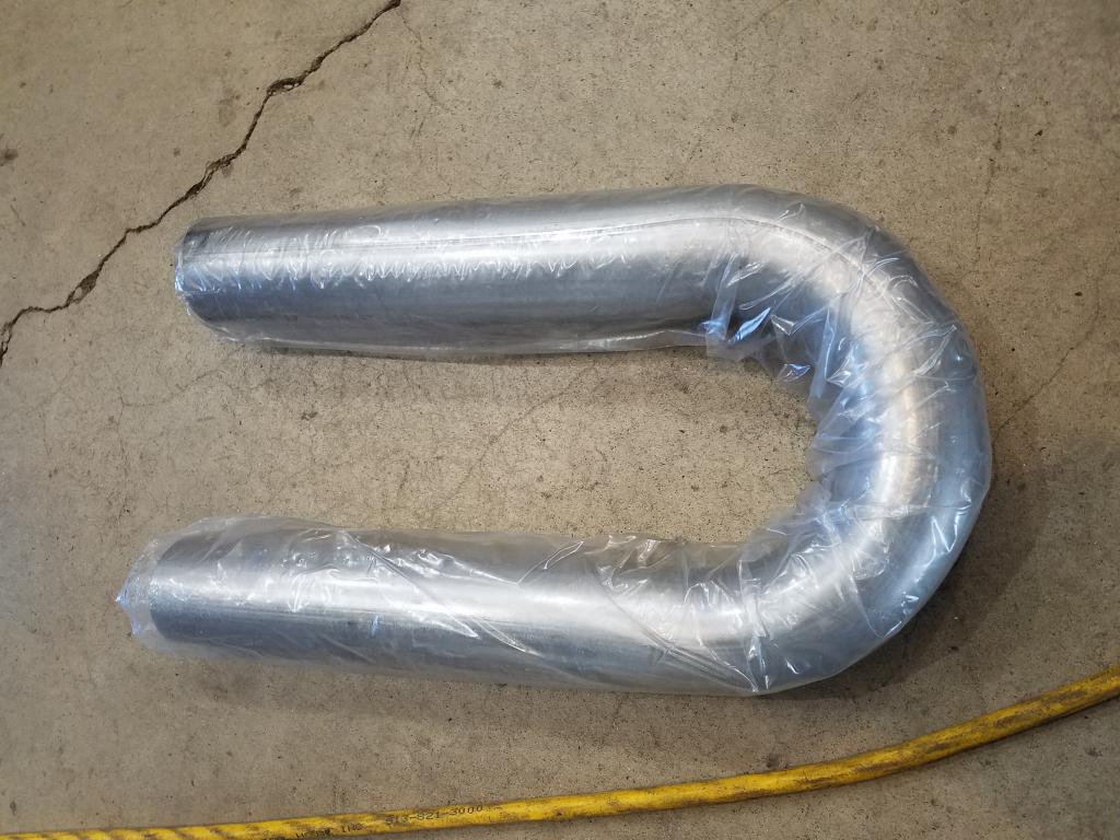

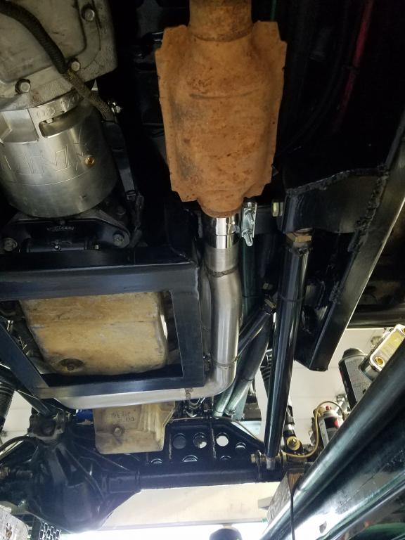

For the exhaust I bought a few mandrel bent 2.5" fittings from Summit Racing.
I had to cross over to the passenger side to keep the heat away from the tcase and fuel lines on the driver side. I used a u pipe to make a y pipe and ran 2 into 1 down the passenger side. All in all it wasn't too bad to do. I did have to buy a set of aftermarket manifolds so the driver pipe didn't exit on my link bar. I used a band clamp so I can separate it in 2 pieces for easy removal from the rig.

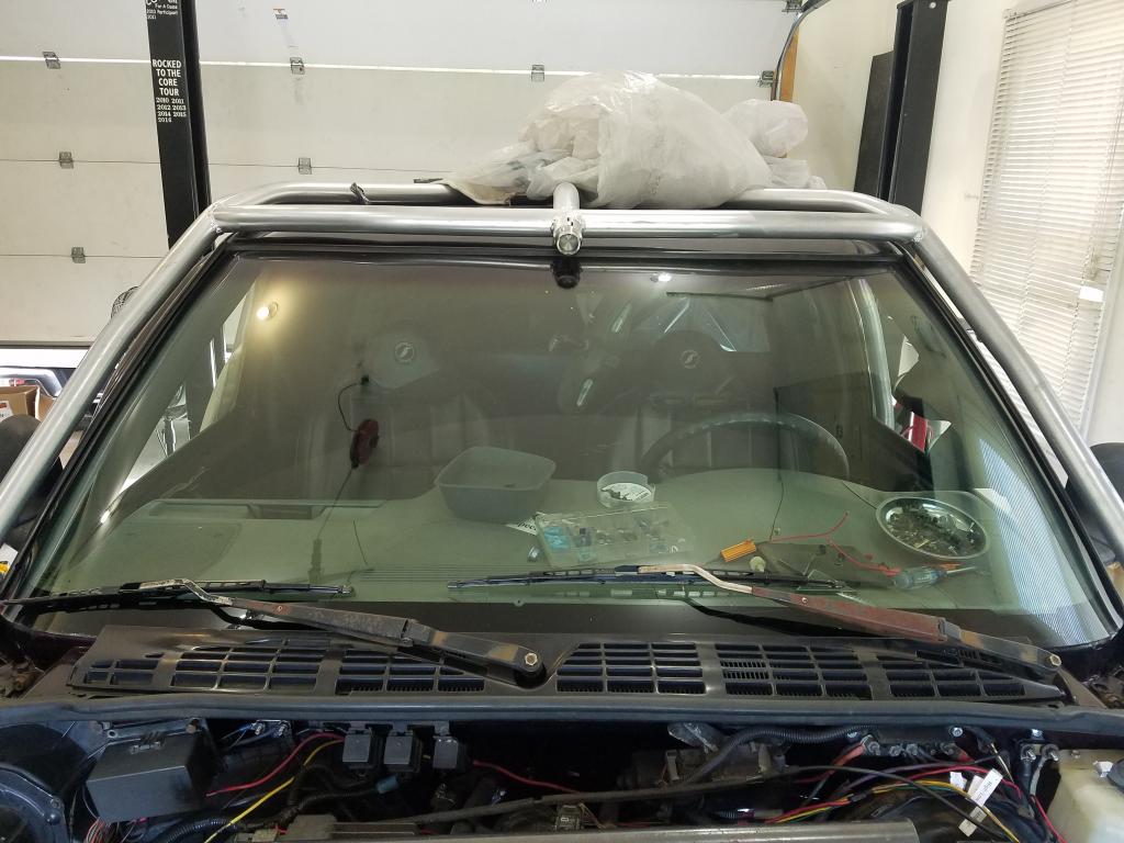

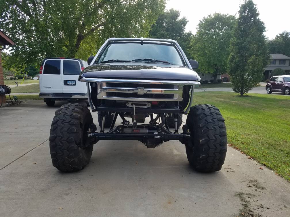

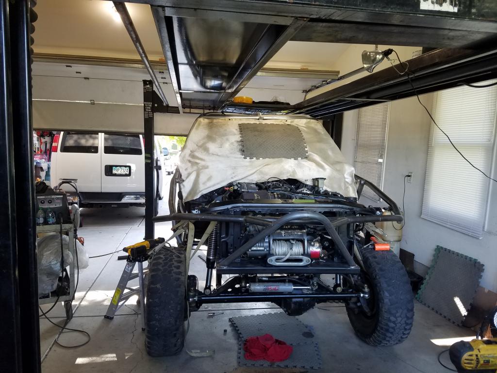

After putting the new windshield in, it was time to finish the front exo. I didn't want to add the bar that most people run across the cowl above the wipers that supports the roof, so I went a different route.
I ran a tube under the hood from fender to fender that supports the the fender exo and the roof support. Just has to notch the fender and hood a bit. Also ties the cross bar to the shock hoop cross bar.
I used tube bungs so I could remove it if I need to. I am still able to remove the fenders and grill with the exo in place.

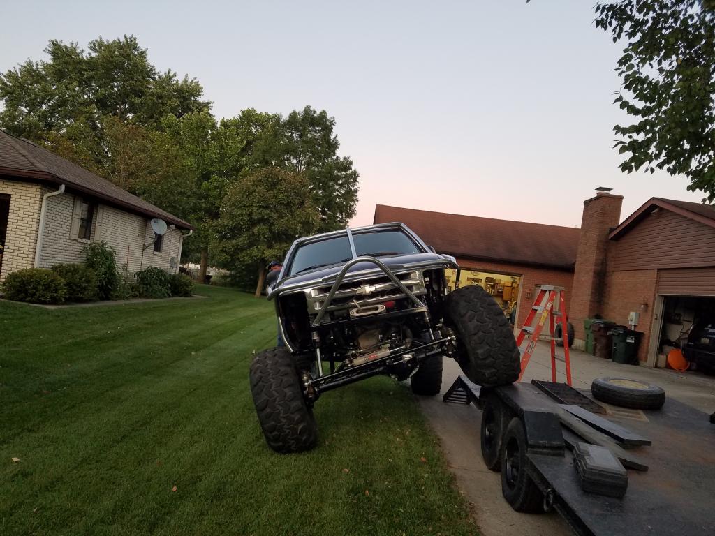

Old 09-05-2019, 10:36 AM   #168
Here is the almost finished product. I still have to make tube doors, install lights, and a skid plate.

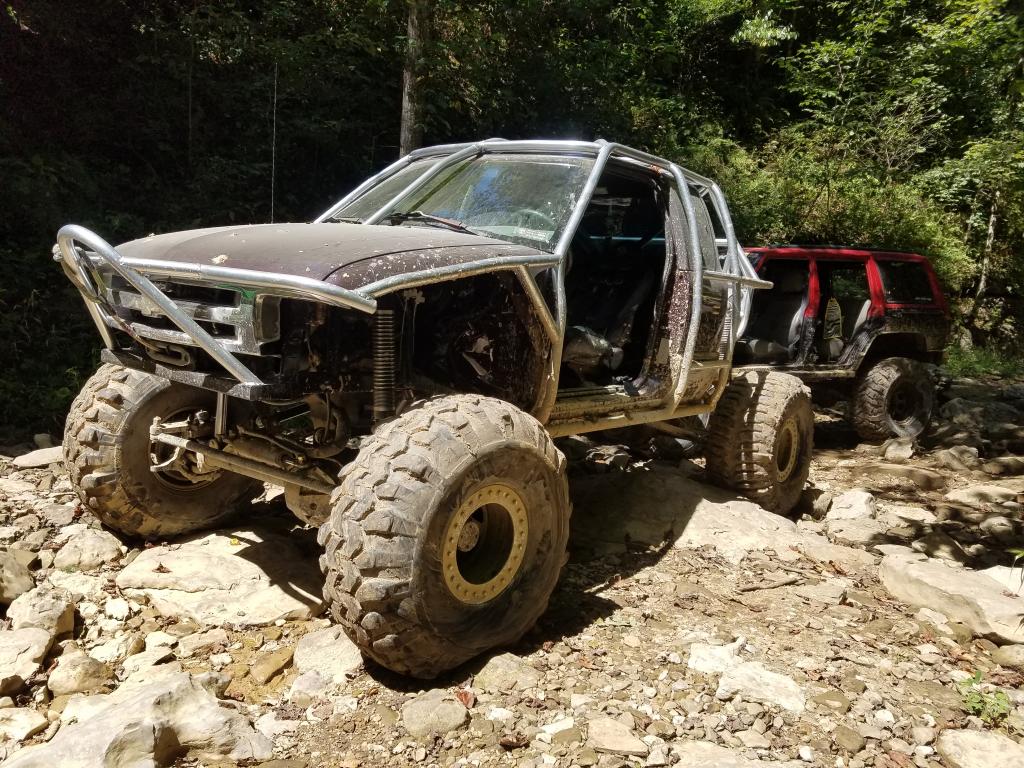

Old 09-05-2019, 11:05 AM   #169

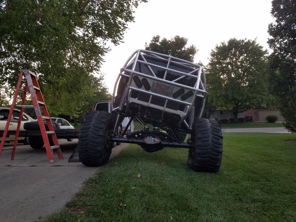

Tried the new rig out at Slade. It did great and no major issues. I made a mistake in thinking all pcm's will utilize the 4 low shift tables. Just because they are showing in the tune, doesn't mean the pcm reads them. So when I switched rigs, I did away with the drive by wire and went to drive by cable. My old pcm would not work, so I used one from a 2003 Express van. After spending $100 on HP tuners credits, I found out that it wouldn't shift in low range. So now I have to find a 4x4 pcm that had drive by cable and spend another $100 in credits. Live and learn I guess...
Didn't take long to knock the new off of it.

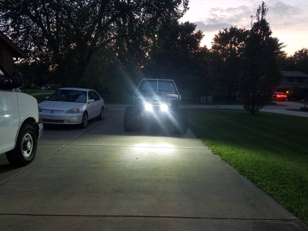

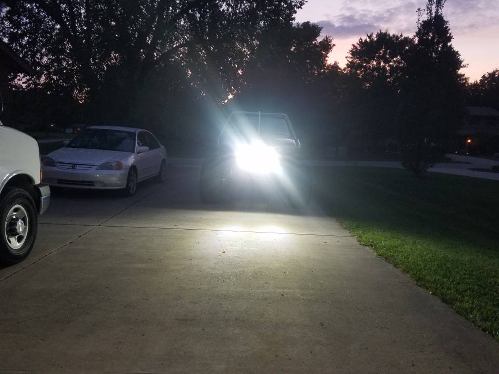

Got my headlights mounted. The low beams run the lower lights that are pointed towards the ground so people aren't blinded and the high beams turn all four lights on. Still have a 42 inch curved light bar to add on the top of the cab..
Low beams
High beams
