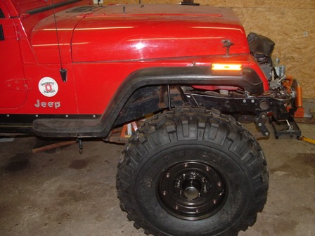

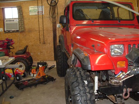

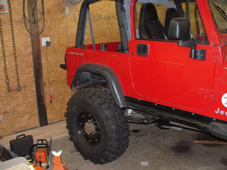

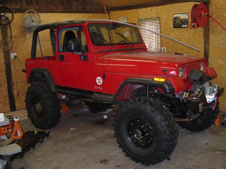

Got the front axle about 90% done. Need to route brake lines and burn on some shock mounts. I mounted it forward 2 inches. Also got the tires mounted. Only problems I ran into was that the bleeder screws are too long and hit the rim. Also had to grind the bolt that holds the brake clip on. Any ideas on the bleeder screw? I am going to try to get a shorter one, otherwise I will just have to grind off the end of the ones I have.
Here is some pics. Also, I am adding some pics of the high steer and front axle in previous posts.

Old 02-17-2008, 03:23 PM   #28
JeepHD
www.buckeyejeepers.com
JeepHD's Avatar
Location: Houston, OH 45333
Posts: 276
Specs.
Height to top of Rollbar with 30psi in tires - 81 inches
Bottom of differential to ground - 12 inches
Front suspension travel - 12 inches
Total wheelbase - 97 inches (Front forward 2 inches, rear back 1 inch)
1994 YJ, 4.0, 5 speed.
Old 02-17-2008, 04:05 PM   #29
Man that looks really good!
Old 02-17-2008, 06:56 PM   #30
do your flanges stick out past the wheel? i'd be afraid of hitting them on rocks?
Old 02-17-2008, 10:16 PM   #31
JeepHD
JeepHD's Avatar
Posts: 276
Thanks
I am concerned about that but plan on running as is for now. Flanges are about even with the outer lip of the rim. Offset an inch or so from th outer part the tire. May eventually change the backspacing on the rims. I would also like a little more width for stability.

Old 02-17-2008, 11:51 PM   #32
ran hummer wheels at stock width with flanges sticking out past for years... no issues. jeff smith's are out past as well as Jim Smith's i believe... dont' worry about it, that stuff is strong. The rear can take the beating, the front can take even more if you go with drive flanges instead of lockouts.

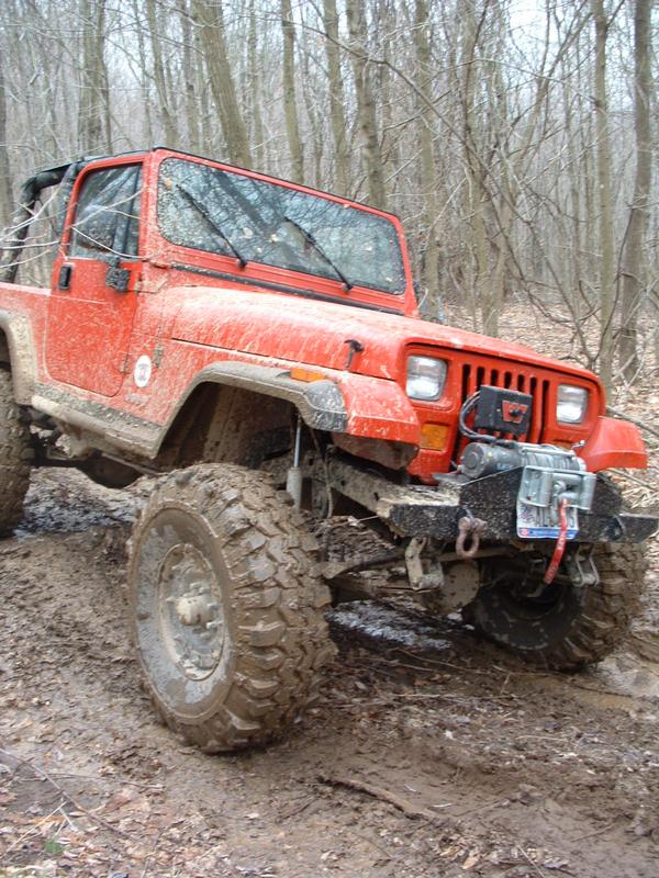

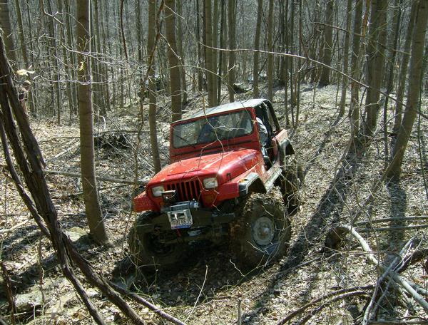

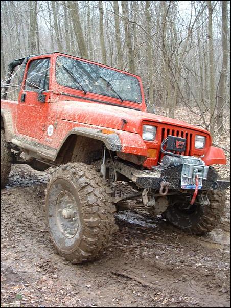

Pics from two weeks ago. Not really any action shots, but proof I was out for the trial run.
