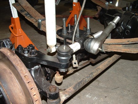

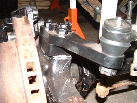

Few pics of the Hi-Steer so far.

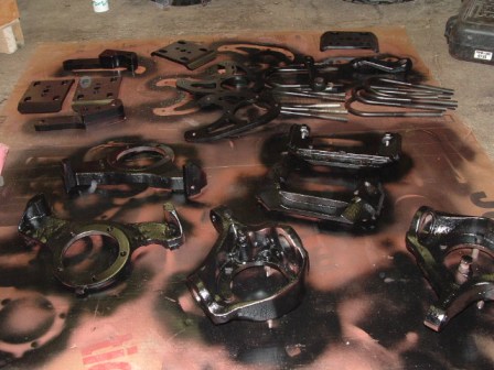

Progress is slow, but getting a lot of small things done. H1 Runflats are cut of and beadlock ring is ground smooth. Sandblasted and painted front axle hub and steering arm parts. Should be able to get the front axle put together quickly and permanently installed.

Just thought I would update on progress. The project is still underway, but progress has been slow. I was able to get the last three H1 wheels sandblasted over the weekend. Should have them painted and mounted up this week. Mostly been waiting for my inner Chromoly shafts, when I originally ordered them, I got F-150 instead of F-250 and there was some length differences. Just got a tracking number and I should have them Thursday (Happy Valentines Day to Me). I plan to have the front end together this weekend and have it on all fours. Will post up pictures when I get the treads mounted up and rolling.

you can make your own rear stak support, or buy theirs... it's super nice, notched to slide to any angle etc...
all looking good by the way...
