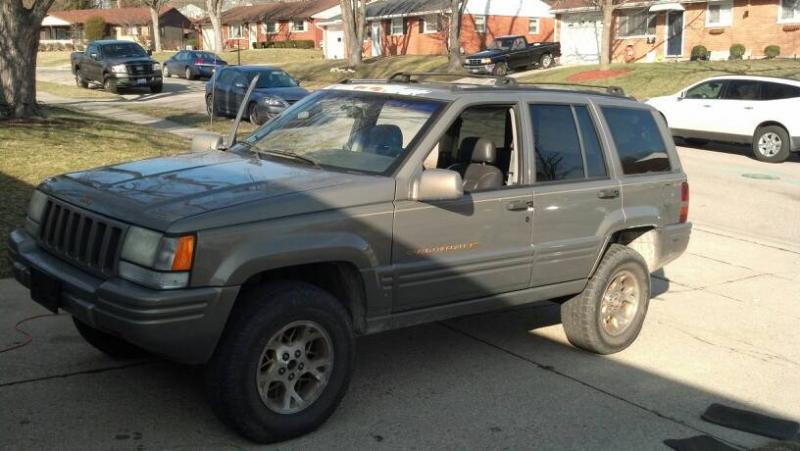

    This is my new wheeler. 97 grand Cherokee limited 5.2
    Plans
    Ford king pin 60 5.38 gears welded
    14 bolt 5.38 gears welded
    Full frame reinforcement
    Exo-cage
    At least 38s on bead locks
    231 with sye
    4 link rear on coils
    3 link front on coils
    Tons of little stuff

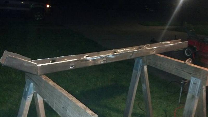

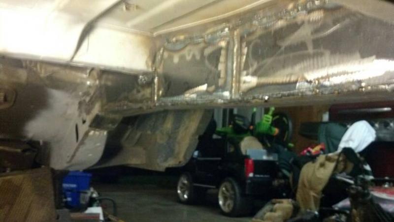

    Progress up to this point has been all the metal work looks like I haven't done much but cleaning the frame of all the stock brackets took forever but I think it was worth it in the end. Rear passenger side welded in all the rest of the pieces are cut out and ready to weld in. I did really like the templates. I have been watching to much extreme 4x4 hahaha

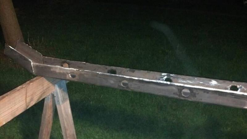

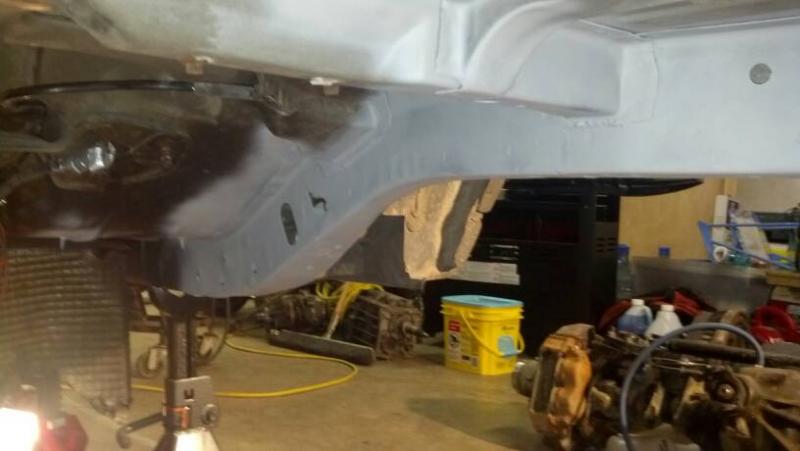

    The passenger side frame rail almost done. Just need to bend the front up at the fender well. All goes as plan and that will be all one piece. Driver side should go faster.

        Nice work frame reinforcement is good idea... We are workin on an xj that's gettin the frame plates ruffstuff makes for em... One question.. Y only 38s if your goin tons? The diffs will drag everywhere.. Go on to a 42" tire u wont regret it

          38s will be the smallest. I plan on cutting a lot of the body out of the way but didn't know if 42s would just be to big. I would like to do the 13 bolt cover for the rear but down the road. I'm sure that boat anchor will drag everything.
          how do you like the ruff stuff rails?

            Ruffstuff rails r bad ass and user friendly... I got buddy with some 42 pitbulls for sale... They only measure 40" tall... Look good on that grand

                  Got all the frame cleaned and ready to weld for the long section under the passenger compartment today and test fit a little. Start on call tomorrow so if I can get that fully welded in and started on the other side within a few days that would be great

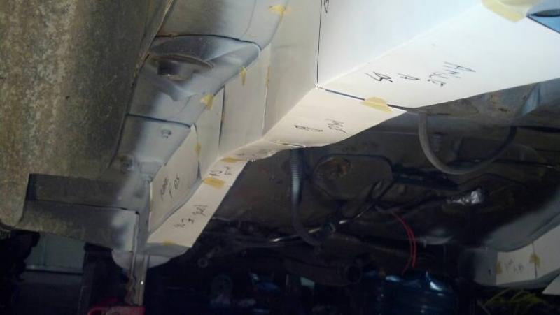

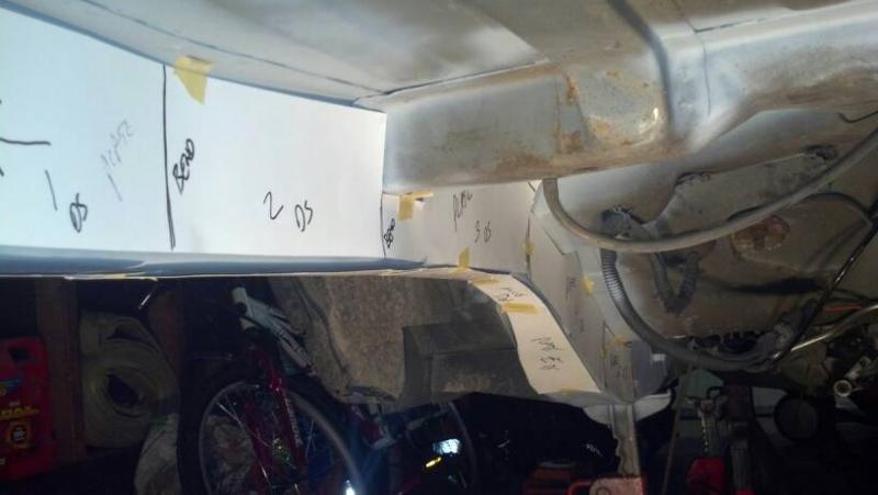

                        Pics of my templates they really have made life a lot easier and cut down on so much test fitting.

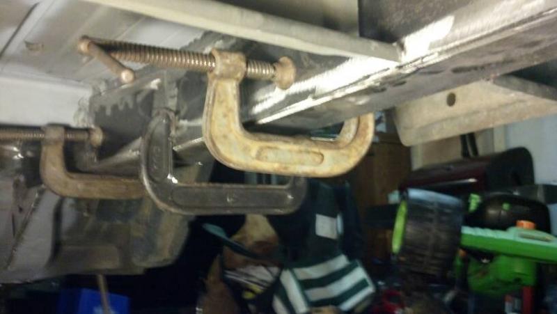

                              Hear you go bud. Been waiting to post a finished side. Passenger side is done from rear bumper to past transmission. I prepped the driver side from the rear bumper and am going to cut the holes in the box tube for under the cab up past transmission for that side this week. Now that I know what my plan is hopefully I can finish that side in 2 weeks. Then the crossmember needs built
