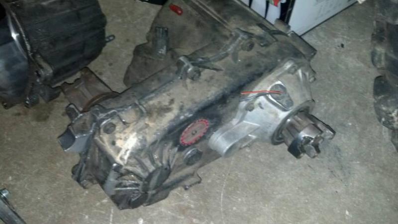

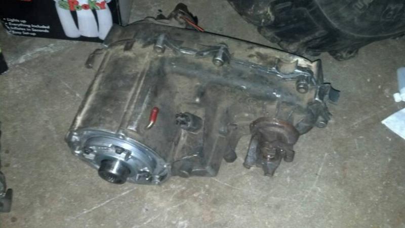

                      After some prying and pulling was able to split the 249 and get out the input and planetary. The 231 was a lot easier to split. It already had a 6 gear planetary that I could use with my input shaft. Cleaned it up and put it back together. Hope to put it up in the jeep in the next few days
                      Thanks to huntingmatt418 joe and rolf

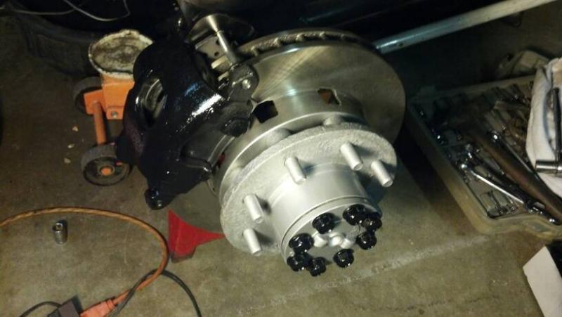

                        Had to order the transfer case to trans studs. I couldn't get the ones out of my 249. So the new case to go in this week.
                        Got the disk brakes on the 14 bolt.

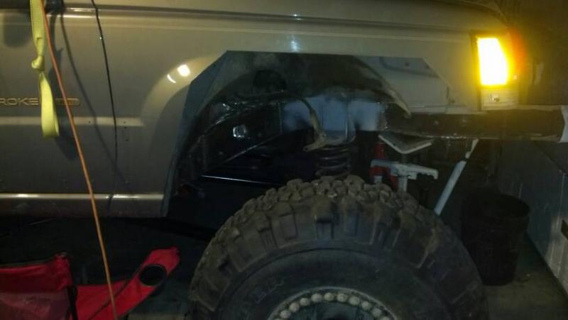

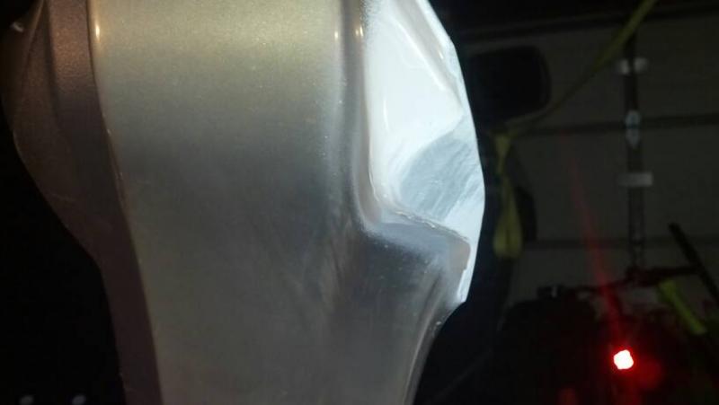

                          Cut the fenders last night. I like the back but rethinking the front. Got some inner fender area to cut out and rebox in the front behind the head lights. The battery box and air box will need moved. Thanks to the guys who came and hung out yesterday

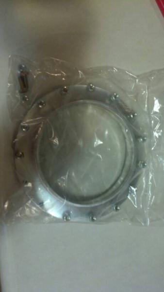

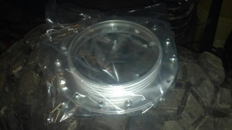

                            Ordered a custom fuel cell from RCI. It is the 30*12*9 but I had them not put in the sending unit or pick up lines on it. I bought a fuel cell adapter ring from genright that uses the stock jeep sender with the In tank pump and regulator.

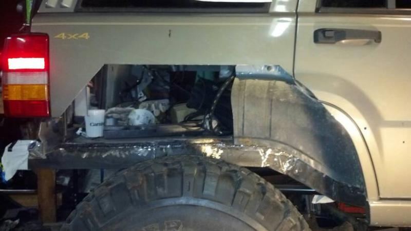

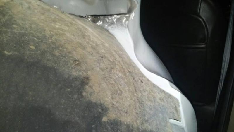

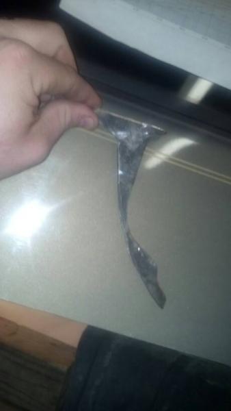

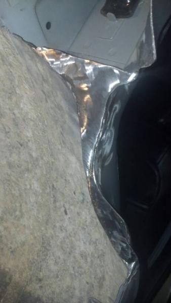

                              A few pics of the fender and door on the passenger side after the cut. I started the fill in process. After a lot of trimming and fitting I got the fill in piece to fit and filled. Not to bad since I hadn't ever worked sheet metal before.

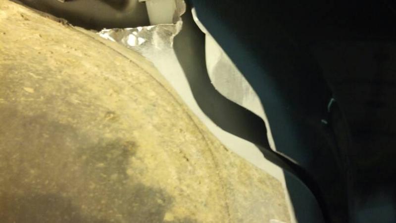

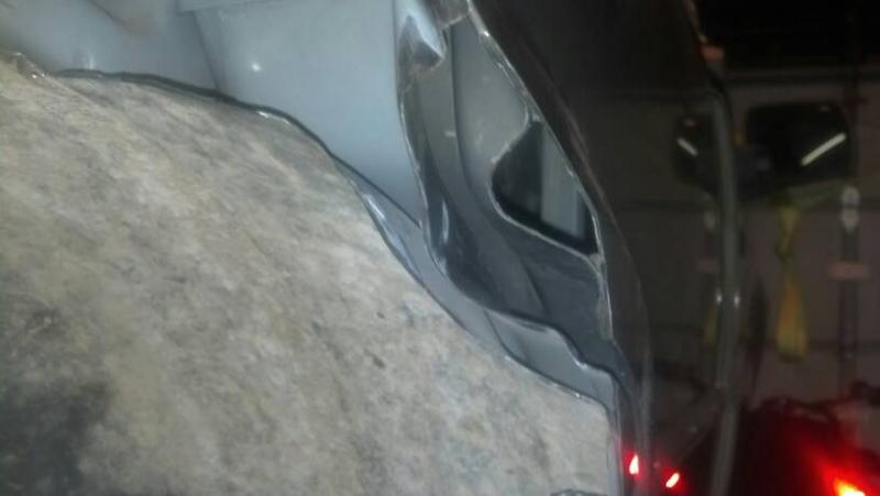

                              • #90
                                Got the door sealed up and the inner fender finished at the bottom.
